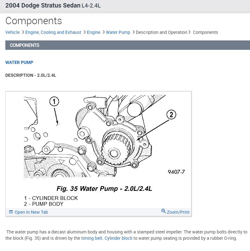

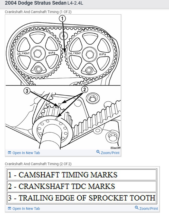

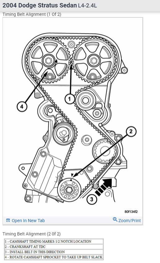

how involved is it to change water pump? i know i can do it just need a few pointers.
Dec 7, 2009 at 8:50 AM
SQM
  • CAR REPAIR CONTRIBUTOR
  • 6,383 POSTS

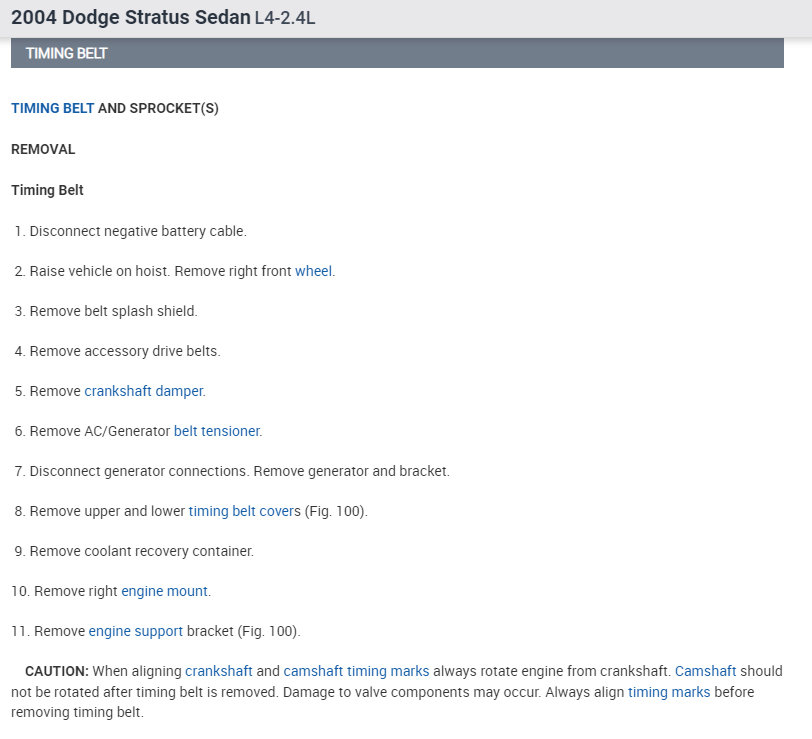

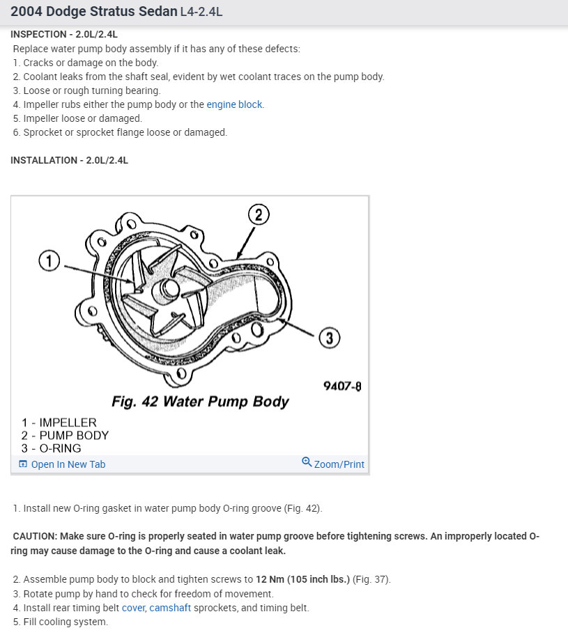

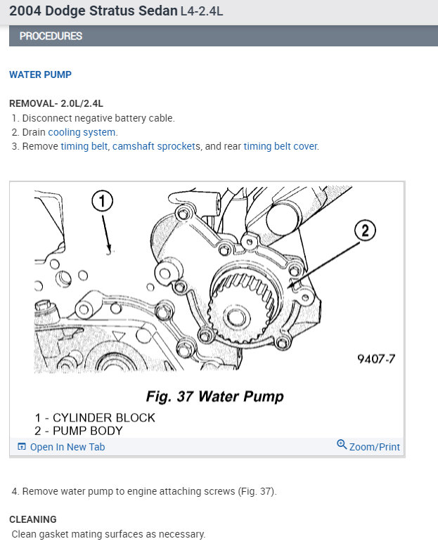

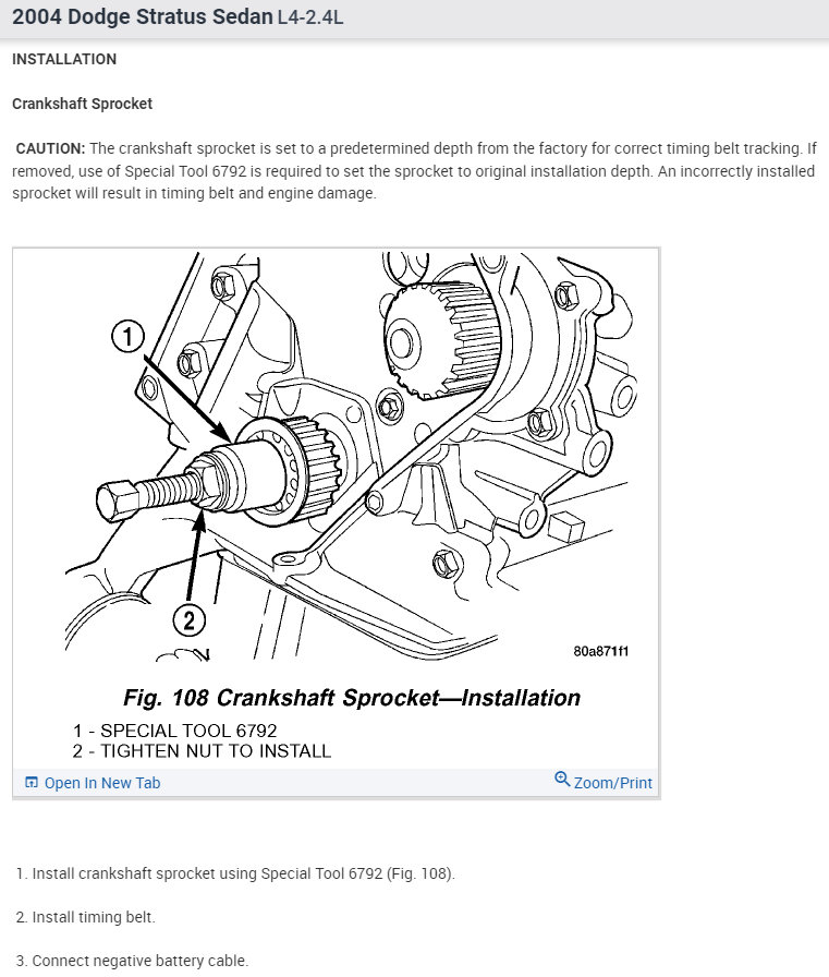

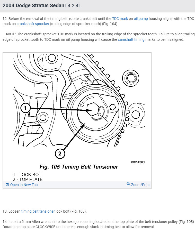

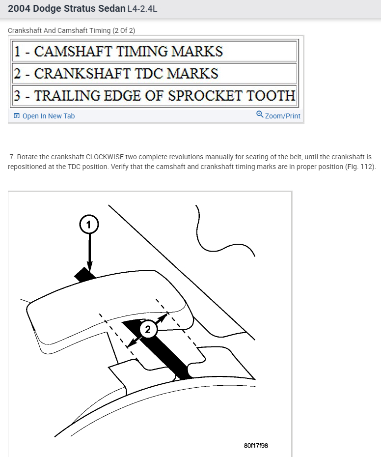

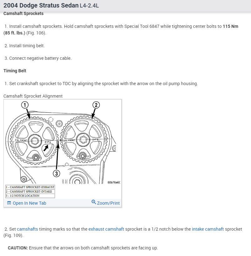

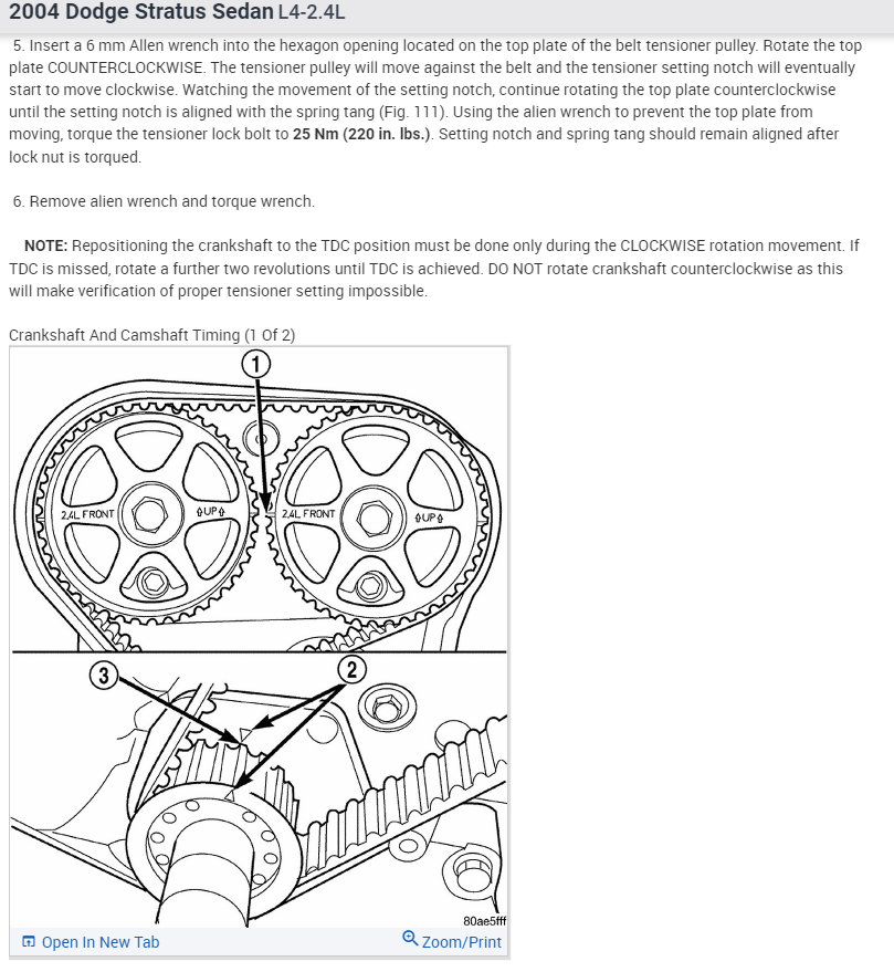

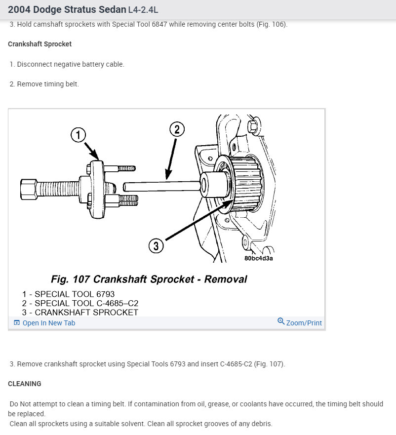

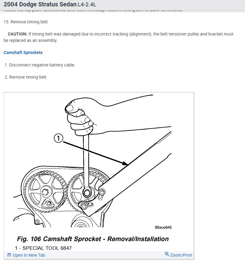

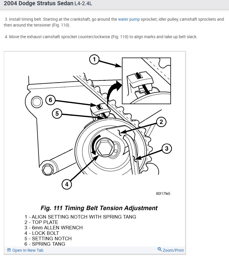

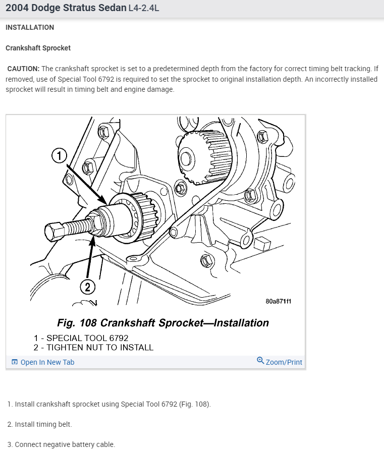

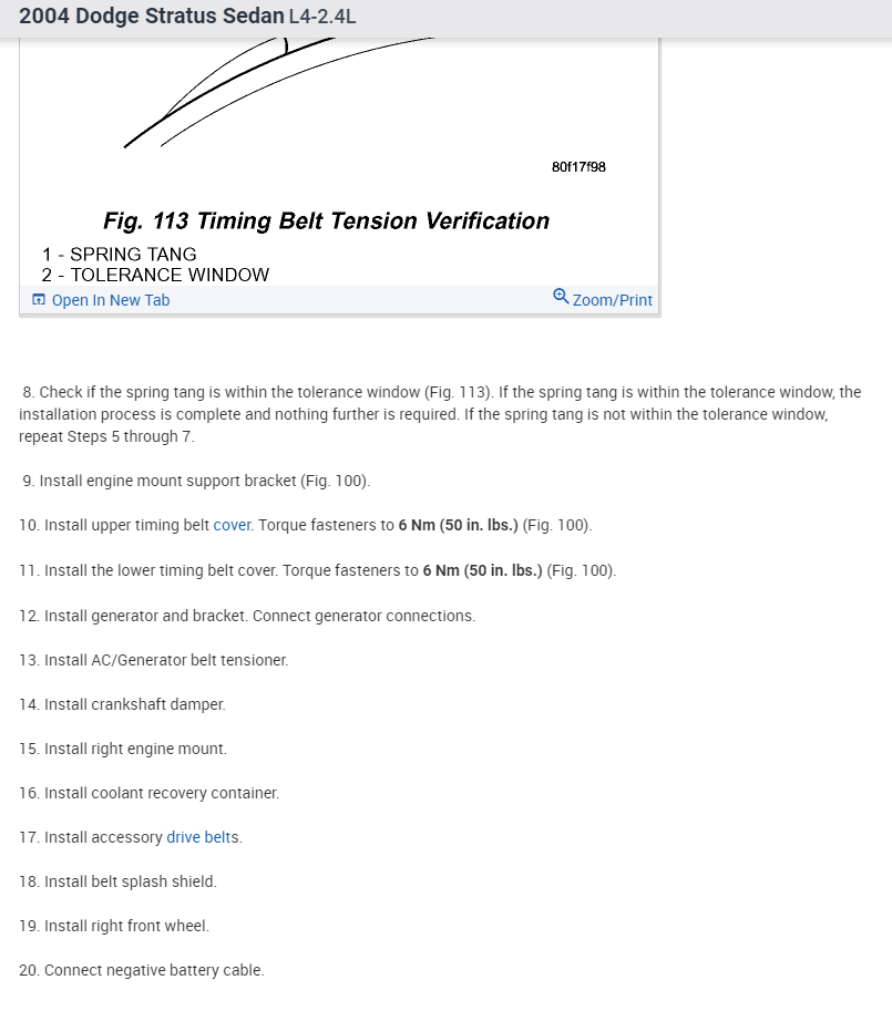

On this vehicle the water pump replacement requires to have the timing belt removed. So, it is a good idea to replace the timing belt while doing the water pump and vice versa.
It can be a labor-intensive process.
Here is a helpful guide that covers the best practices for water pump replacement:
https://www.2carpros.com/articles/water-pump-replacement
I have attached diagrams for the replacement of the water pump and timing belt below for your reference.
