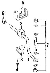

in te rear wheel well of the car there is a bar that has a bolt on each end, it snapped and I have called around asking about it and no one knows what the piece is can u tell me?

https://www.2carpros.com/forum/automotive_pictures/55316_PM01500_1.jpg
Is this it?
1) Stabilizer bar
2) Bushing Bushing Back
3) Bracket Bracket Back
4) Bolt Bolt Back
5) Mount bracket Right
6) Bolt Bolt Back
7) Stabilizer link (Back) Sometimes people call it sway bar link kit.
