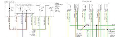

Engine cranking, do you have primary voltage at the coil, dark green wire with lite green tracer. If no voltage that comes from the asd relay. The asd relay also supplies voltage to the injectors, possibly 02 heater circuits and maybe other.
Check for voltage at the fuses in the diagram, use voltage tester. It is possible the computer isn't grounding the relay for some reason, that is why a troublecode, if there are any, might come in handy. A couple of those fuses won't be hot unless the relay is energized.
https://www.2carpros.com/forum/automotive_pictures/170934_stratus_ignition_coil_1.jpg

I can't read the wiring diagram that you sent. I tried to enlarge it but it was to blurry.I ordered a manual for the car so I can see the diagram better.I am going to put a timing belt on car after I get the manual because it has 125000 on it and has never been changed.I was told that it should have been done around 70000. If you have any suggestions I would be glad to here them. Thanks for the direction on the wiring diagram and when I get the manual I am going to investigate it further.I will let you know the out come thanks again for the help.

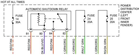

I enlarged part of it. The fuses on the right won't be hot, unless the relay is energized.
https://www.2carpros.com/forum/automotive_pictures/170934_dodge_stratus_asd_relay_1.jpg
