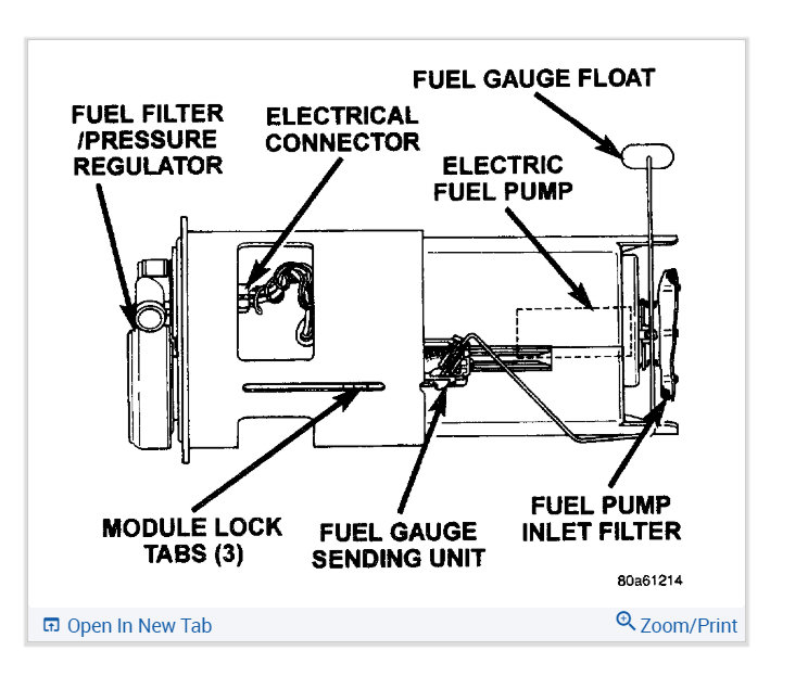

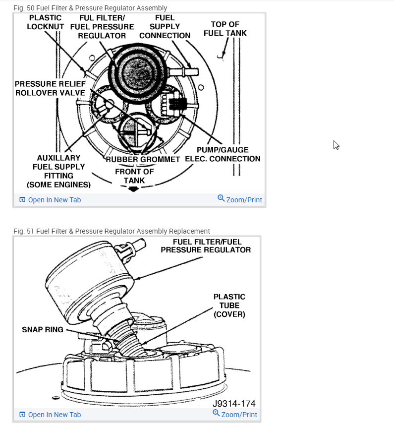

1997 Dodge RAM 1500, 80,000 miles, 5.2 L:
Is the fuel filter located inside the fuel pump? If so, do I get a new filter when I buy a new fuel pump? - Thanks

No it's above the gas tank.
