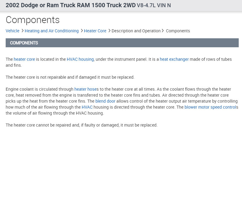

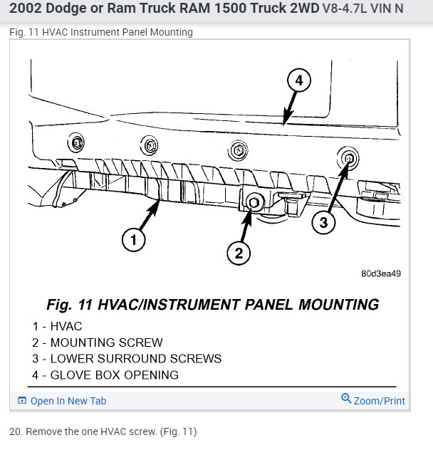

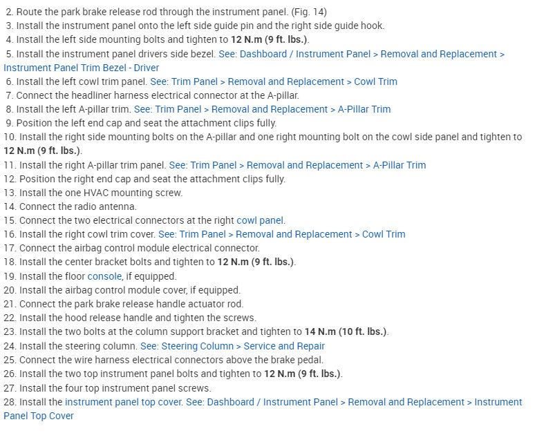

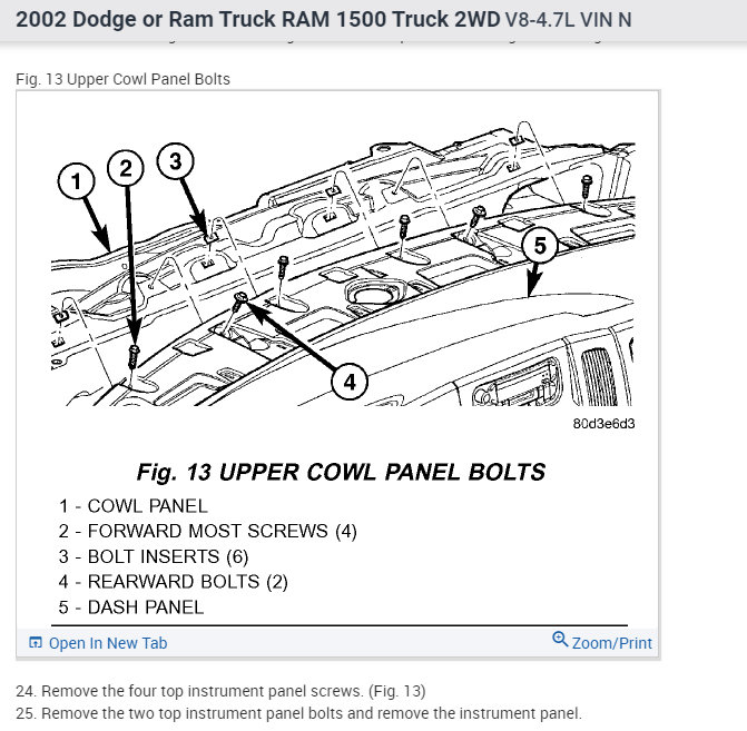

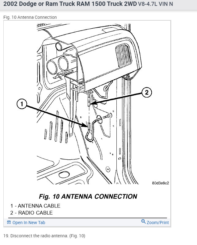

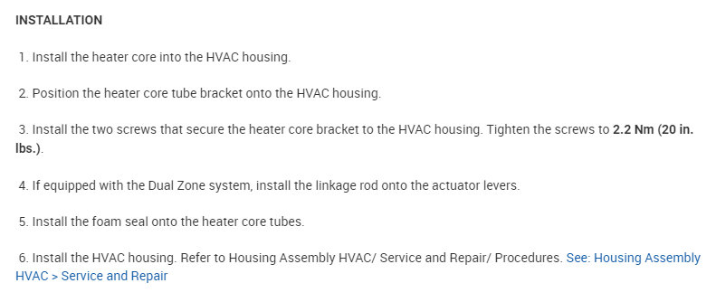

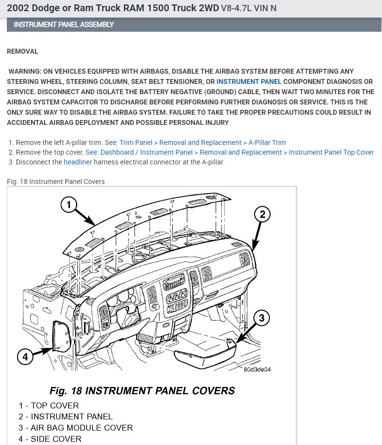

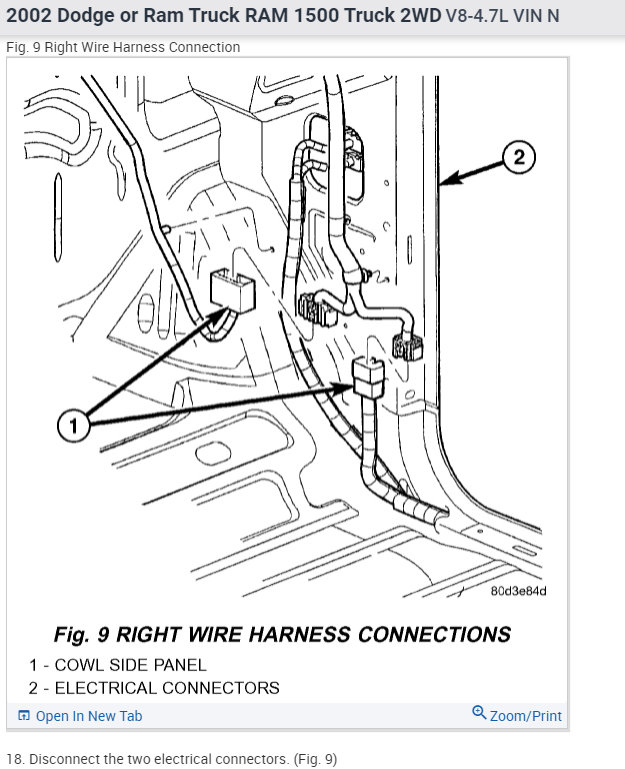

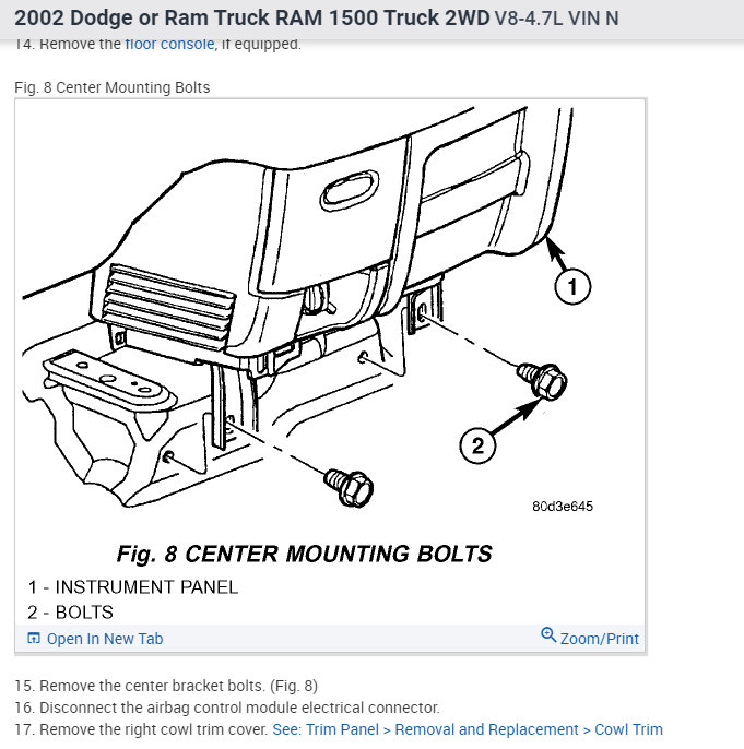

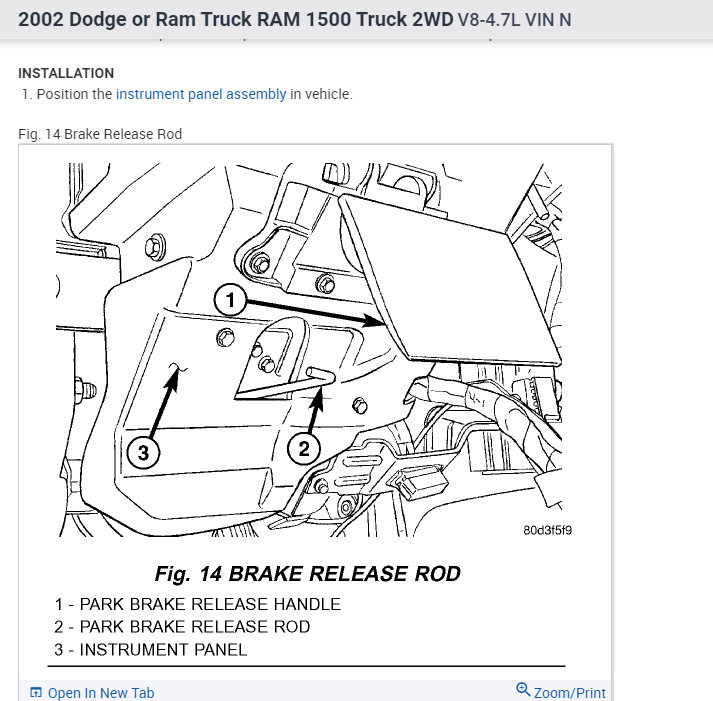

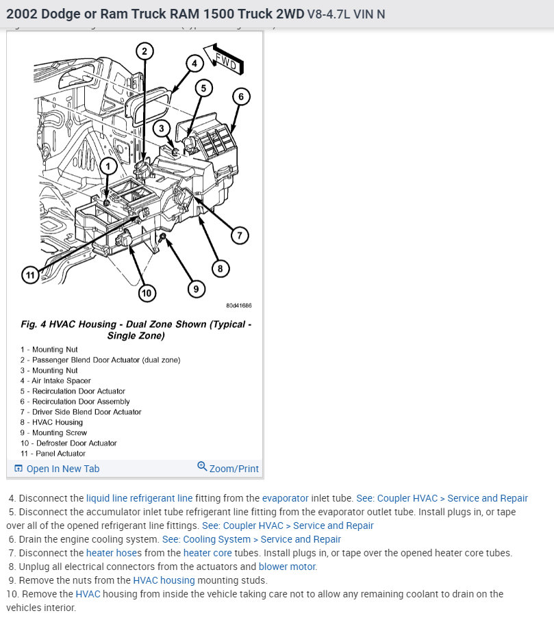

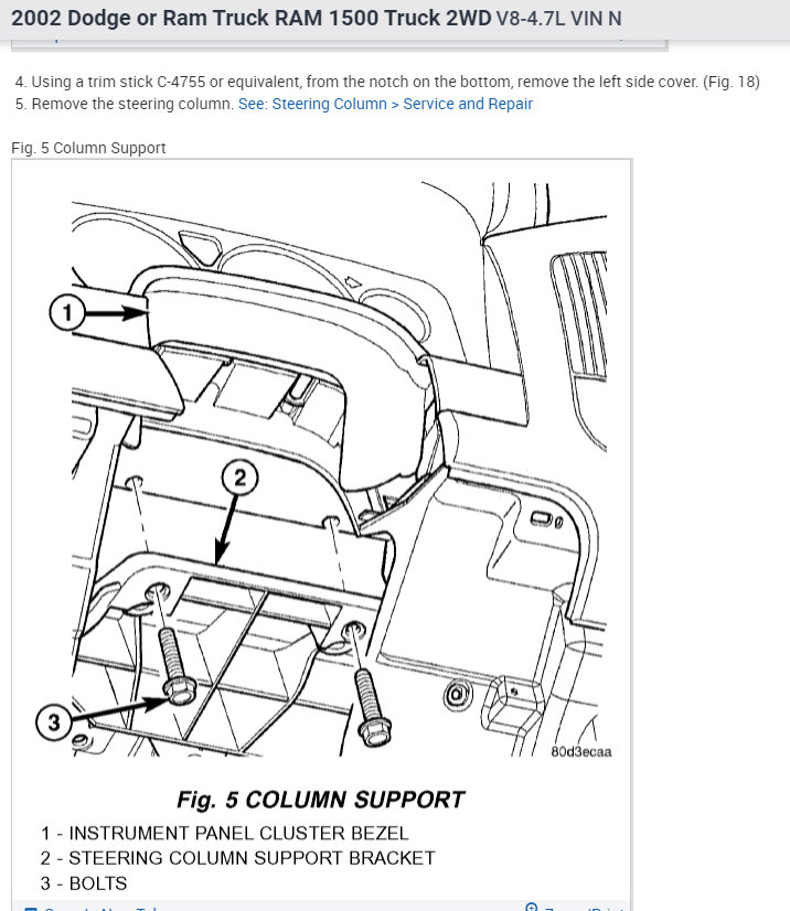

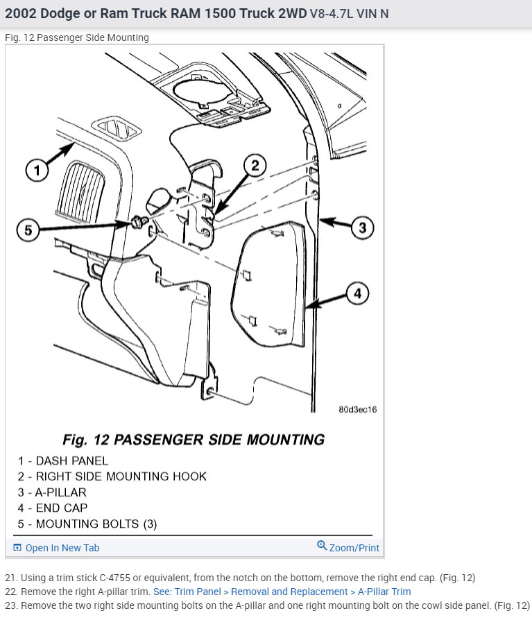

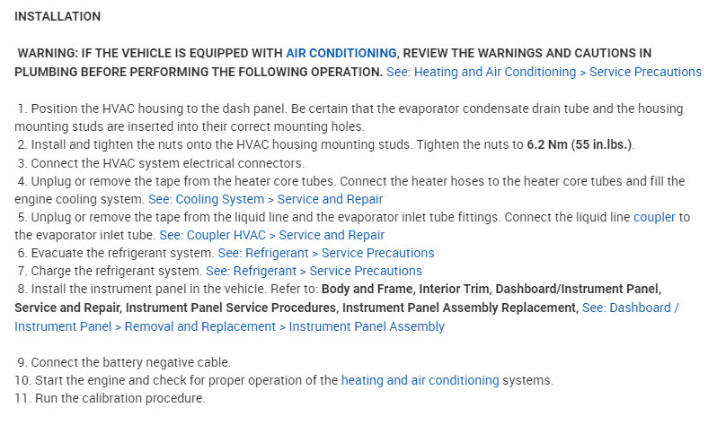

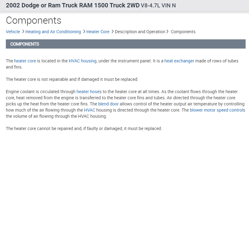

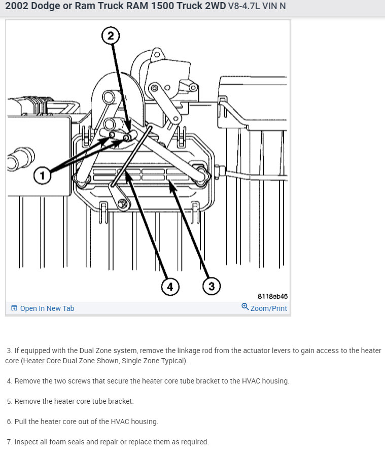

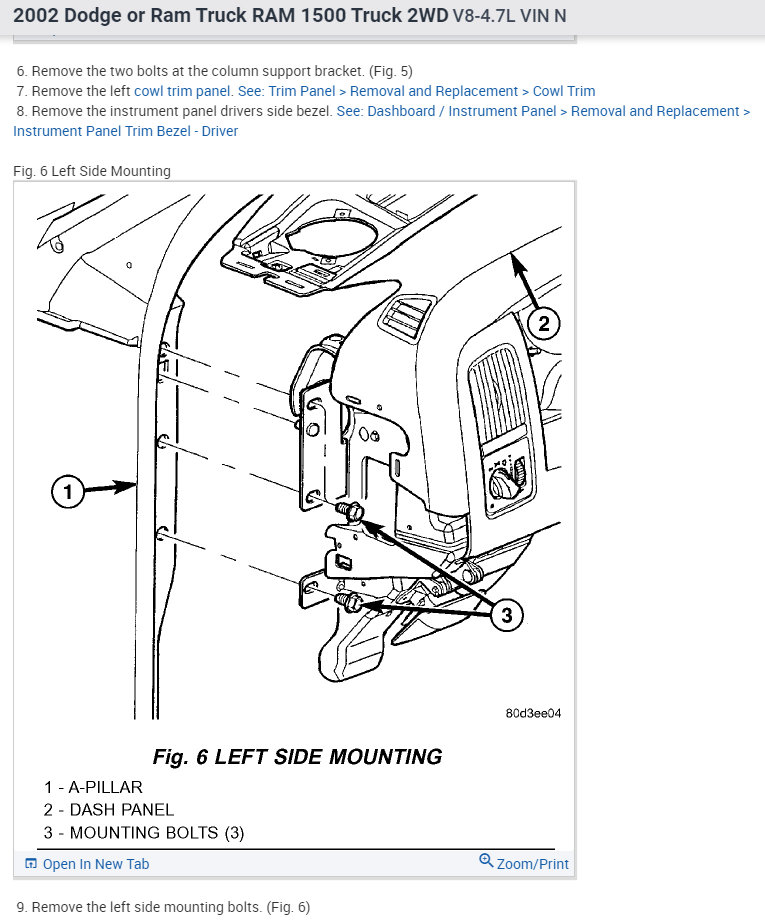

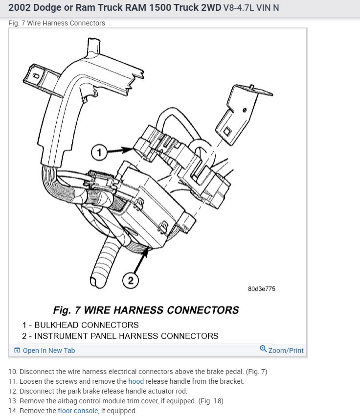

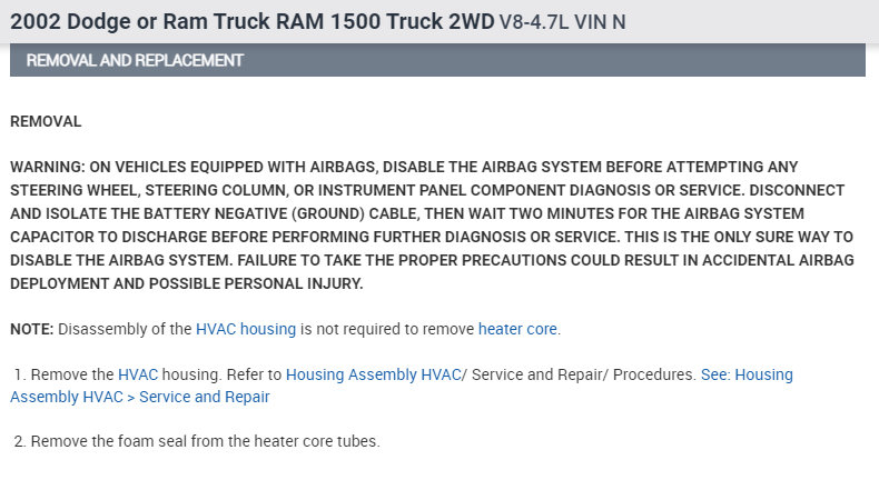

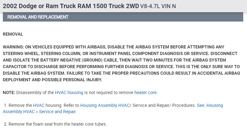

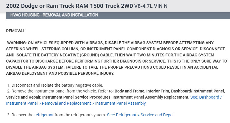

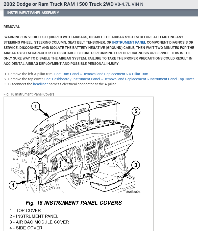

In order to replace the heater core on this vehicle, the dash need to be removed.
Here is a helpful guide:
https://www.2carpros.com/articles/replace-heater-core
I have attached the complete replacement procedure below
