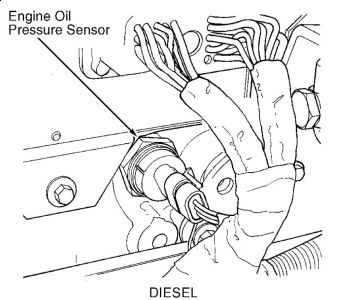

where is the oil pressure sending unit located for a 2001 3500 dodge cummins engine

Left side of the engine near ECM...
If not there try, Oil pressure sensor is located below the fuel filter right above the starter
