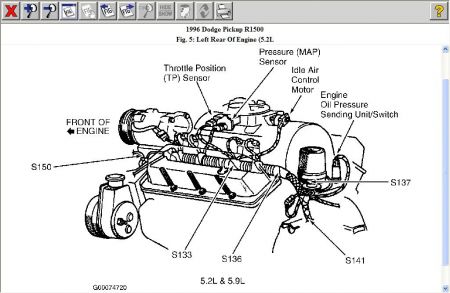

1996 DODGE RAM
V8 two wheel drive automatic 200,000 miles.
I need to know the location of the oil pressure switch on the 1500 model.

5.2/5.9L engine it is near the distributor. See below:

I had to tape a mirror to the firewall to see mine and change it.
