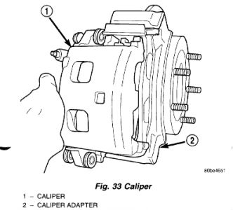

I need to replace the disc brake pads on the front wheels. All the online information that I can get online shows a brake system that is very different than mine. How do I find a system like mine?

Compress caliper.
Remove caliper.
https://www.2carpros.com/forum/automotive_pictures/12900_r1_1.jpg
Remove caliper by tilting the top up and off the caliper adapter. NOTE: Do not allow brake hose to support caliper assembly.
https://www.2carpros.com/forum/automotive_pictures/12900_r2_1.jpg

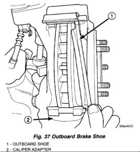

Remove inboard brake shoe from the caliper adapter.
https://www.2carpros.com/forum/automotive_pictures/12900_r3_1.jpg
Remove outboard brake shoe from caliper adapter.

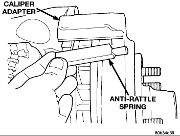

Top Anti-Rattle Spring
https://www.2carpros.com/forum/automotive_pictures/12900_r4_1.gif
https://www.2carpros.com/forum/automotive_pictures/12900_r5_1.jpg
Remove the anti-rattle springs from the caliper adapter. NOTE: Anti-rattle springs are not interchangeable.
Tuesday, March 30th, 2021 AT 9:34 AM
VEYO409
These diagrams/pictures are nothing like what I have on my pickup. Mine has 8 lug nuts on it, you loosen 2 bolts and the whole thing comes off together, it's almost impossible to remove the anti-rattle clips without destroying them ( I put new ones on). Then when you put them back together there is an order that you need to follow to get it to work, the diagrams/pictures that you sent shows none of this. It would have been really helpful! Thanks
