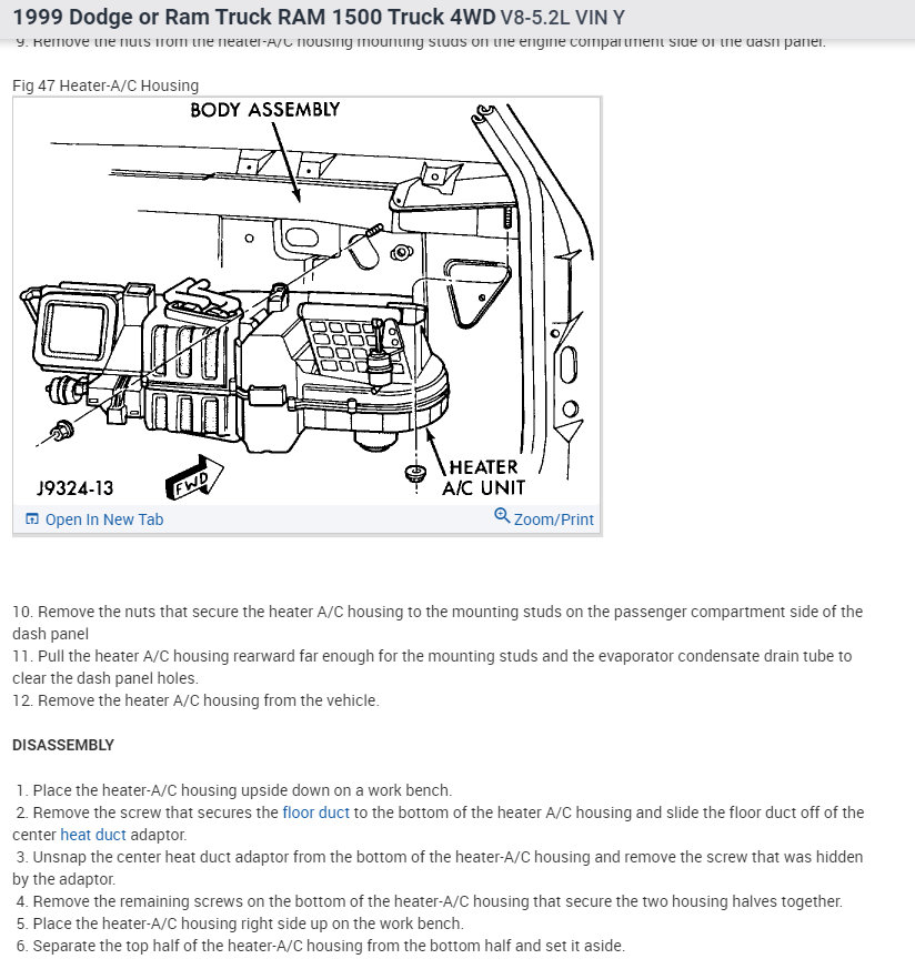

I need a picture diagram on how to replace heater core.
JAMESDEAN247
Oct 18, 2010 at 11:24 PM
SQM
  • 6,383 POSTS

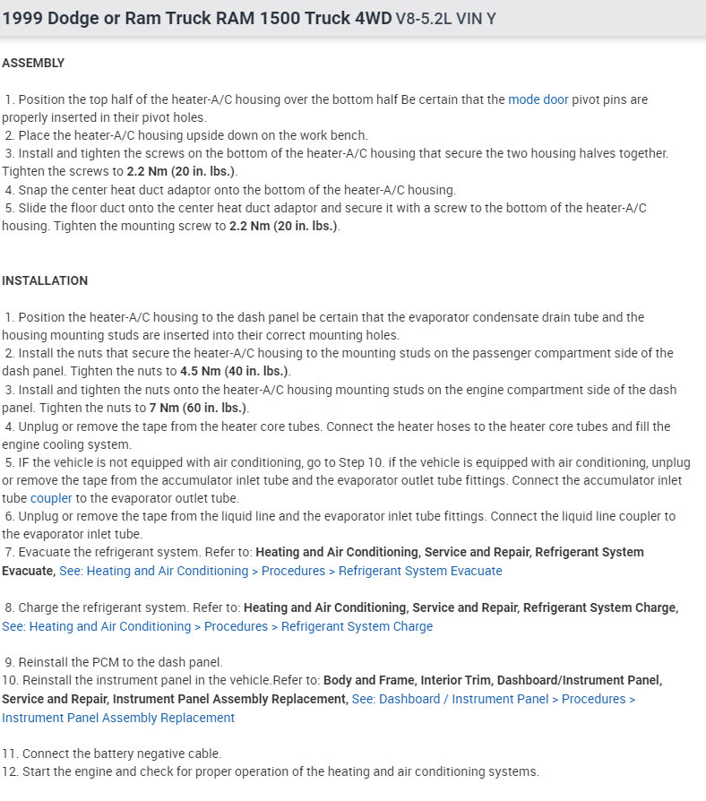

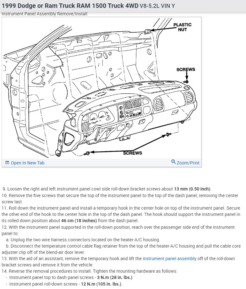

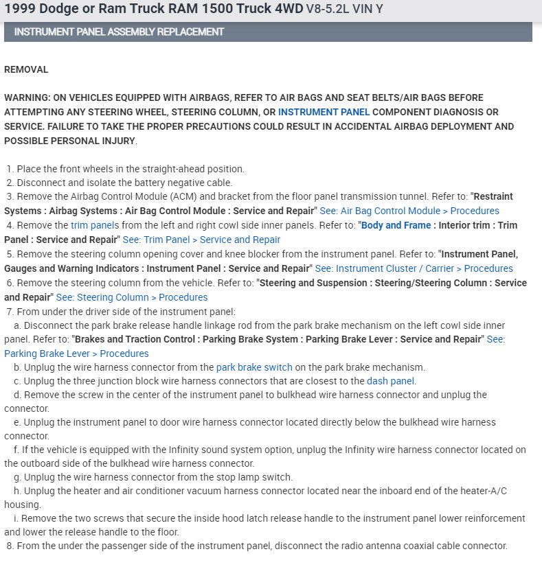

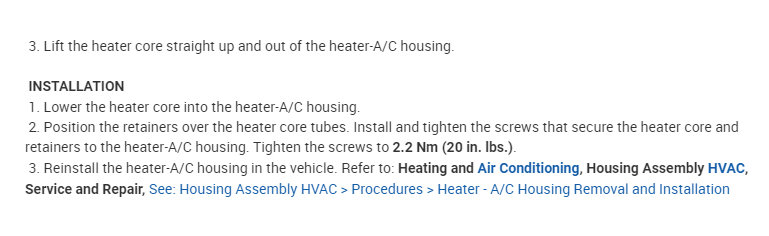

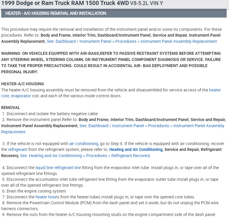

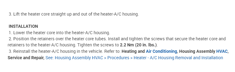

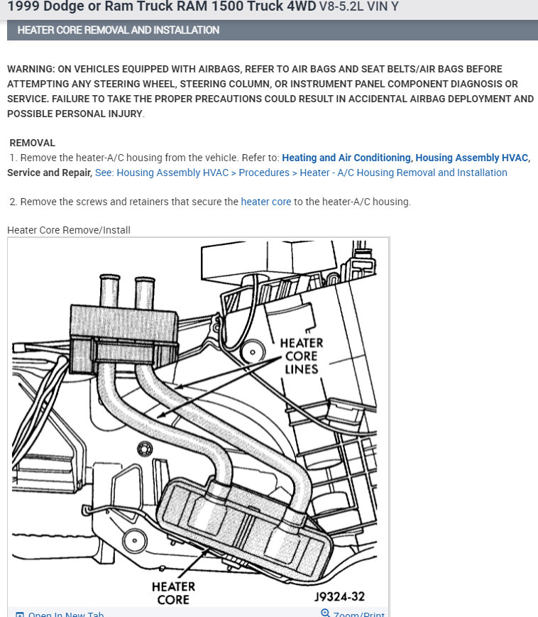

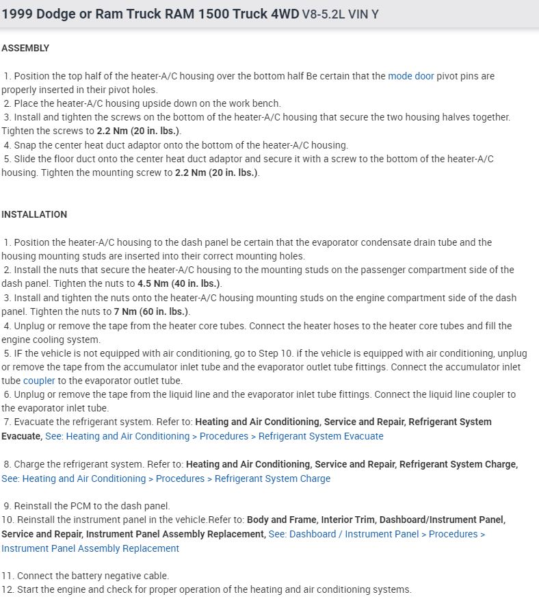

In order to replace the heater core, the dashboard needs to be removed.
Here is a helpful guide on heater cores:
https://www.2carpros.com/articles/replace-heater-core
I have attached diagrams and step by step instructions for your reference.
