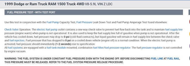

What is the correct fuel pressure for my 1999 dodge ram 15000 5.2L 4-wheel drive pick up.

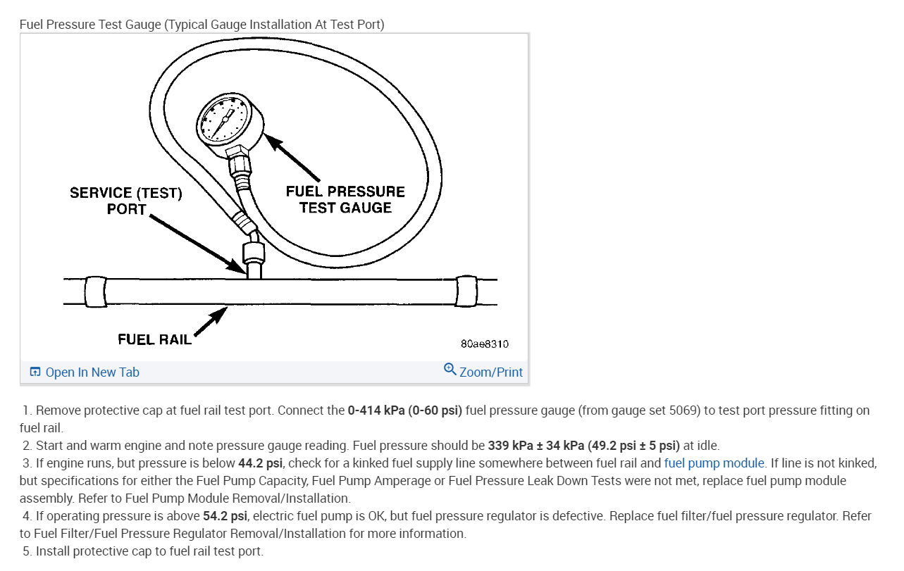

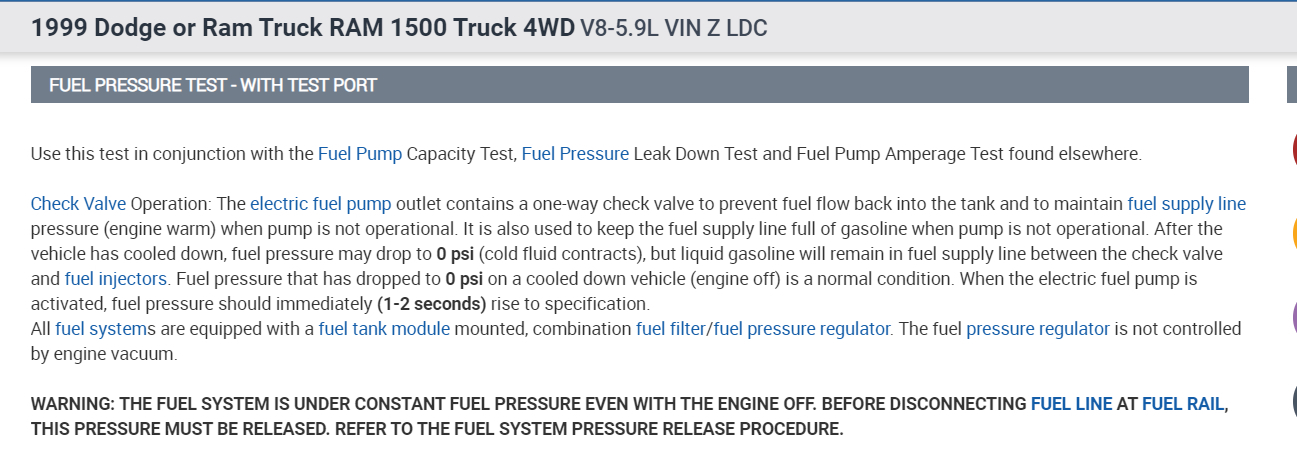

Fuel pressure at Idle is between 44 & 54 psi.
Here is a guide to help you run the test with instructions over your truck in the images below.
Check out the images (Below). Please let us know if you need anything else to get the problem fixed.

The fuel pressure should be 44-54psi as specified
