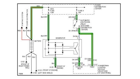

CAN YOU TELL ME WHAT COULD BE WRONG? MY TRUCK DIED ONE DAY LAST WEEK. I WAS STARTING TO LOSE BATTERY POWER FOR 2 DAYS IN A ROW. MY HEADLIGHTS WOULD GO LOW AND MY AMPS WERE READING REALLY LOW. I CHECKED ALL MY CONNECTIONS & HAD MY ALTERNATOR TESTED (IT WAS 50/50) SO I THOUGHT IT WAS THE ALTERNATOR. I REPLACED THE ALTERNATOR & HAD MY BATTERY RECHARGED. I STILL HAVE NOT MORE THAN 9 AMPS READING. MY TRUCK WILL START BUT IT WILL NOT STAY STARTED. I HAVE CHECKED ALL OF MY WIRES AND CONNECTIONS AND I CANT FIGURE OUT WHAT'S WRONG. ANY IDEAS?

Your problem is being caused by the the built-in voltage regulator in the computer not maintaining the alternator's current output. Also might want to test the auto shutdown relay
See below
http://www.2carpros.com/forum/automotive_pictures/12900_alty_7.jpg
