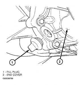

I have a dodge neon 2004 with a 2.0 motor it's a manual transmission. I do not have a owns manual, so I would like to ask if you could help me out by assisting me with lettin me know where I can insert transmission fluid into my car? Thank for your help and time

It depends on which transmission is equipped on your vehicle. the T350 manual tranny has a fill plug on the left side of the transaxle differential area. If you have the T850 manual tranny, there will also be a fill plug on it which is shown in the pic below..
https://www.2carpros.com/forum/automotive_pictures/261618_Graphic_588.jpg
This guide will help walk you throught he service.
