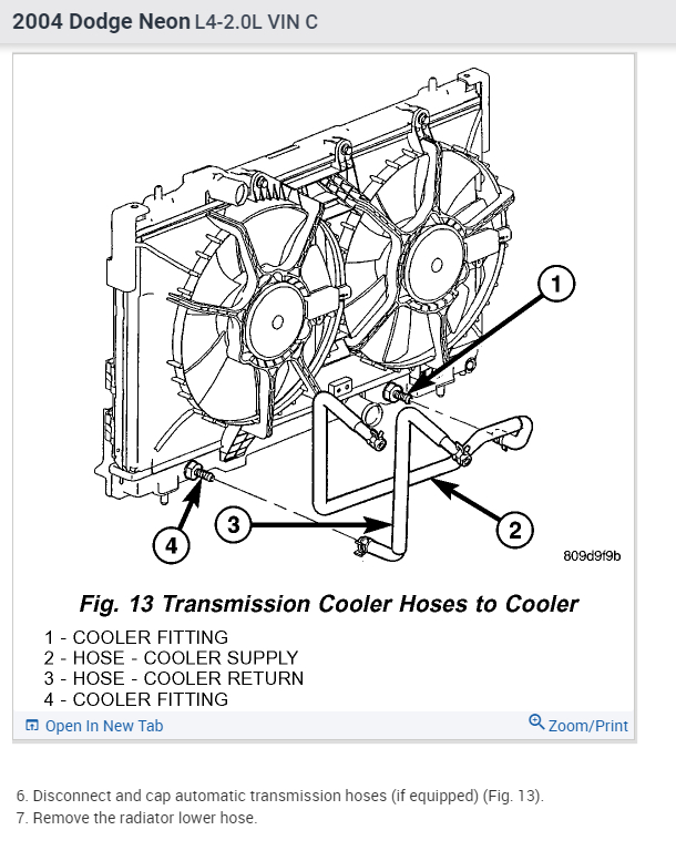

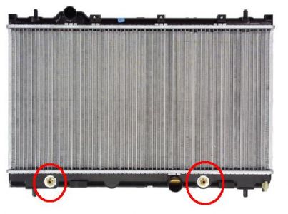

https://www.2carpros.com/forum/automotive_pictures/55316_04neonrad_1.jpg
Did the mechanic tell you where he found the transmission fluid in the radiator? Was it mixed with the antifreeze? If so, how would he know that was transmission fluid. The reason for the concern is that you should have transmission fluid in the radiator. Your automatic transmission relies in the radiator to keep the fluid cool. See red circle. Those are where the transmission hoses connected to the radiator.
If you smelled something that you have never smelled before, I would advise against taking the planned trip until you get in touch with the mechanic.

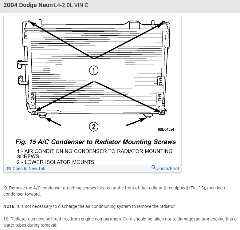

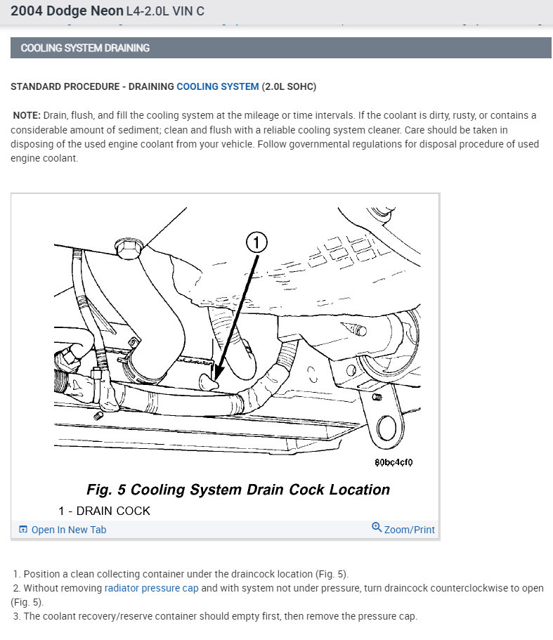

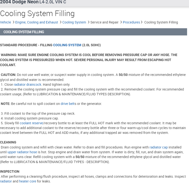

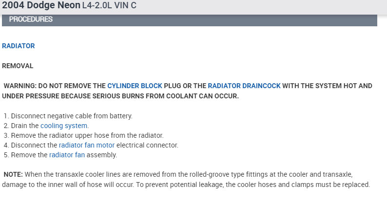

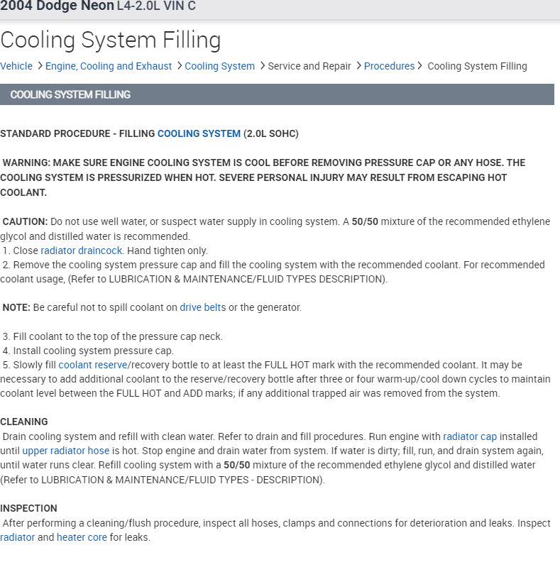

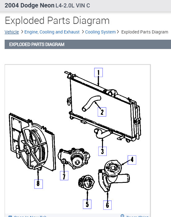

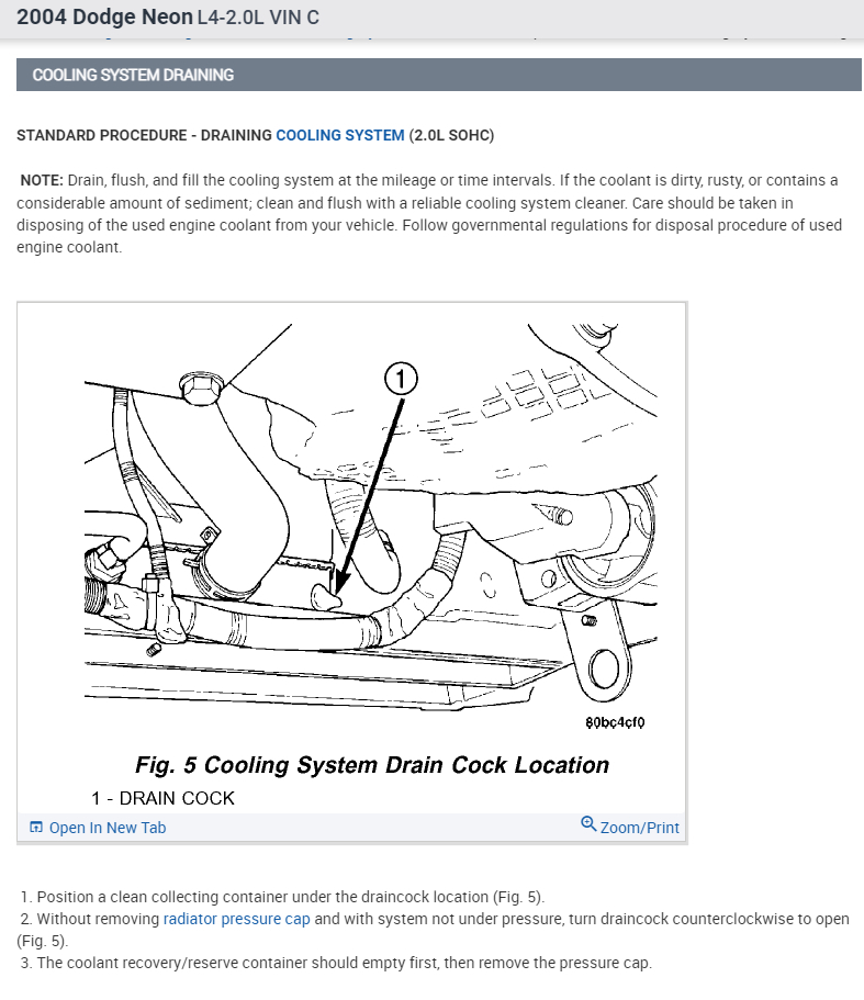

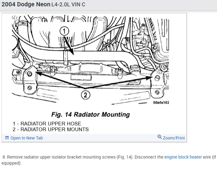

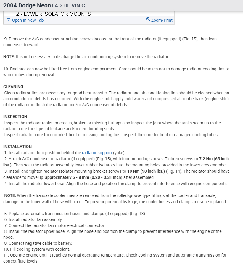

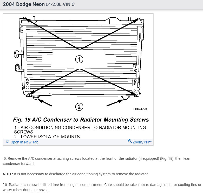

Here are some helpful guides on radiator replacement and drain and flush of the cooling system.
https://www.2carpros.com/articles/how-to-replace-a-car-radiator
https://www.2carpros.com/articles/replace-radiator-hoses
https://www.2carpros.com/articles/coolant-flush-and-refill-all-cars
I have also attached the radiator replacement diagrams for anyone looking for those instruction.
