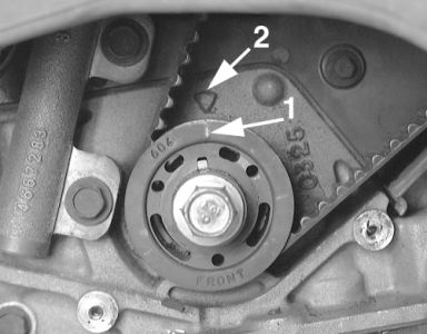

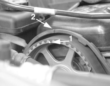

Remove the timing belt cover.
Align the camshaft timing marks.
https://www.2carpros.com/forum/automotive_pictures/261618_0900c152800b1f6a_3.jpg
https://www.2carpros.com/forum/automotive_pictures/261618_0900c15280079066_1.jpg
Loosen the hydraulic timing belt tensioner retainers, then remove the timing belt. Do NOT loosen, tighten or remove the tensioner pivot bolt.

Set the crankshaft sprocket to TDC by aligning the sprocket with the arrow on the oil pump housing, then back off 3 notches before TDC.

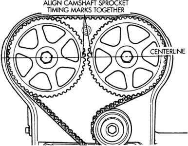

Set the camshaft timing marks together by aligning the notches on the sprockets.

Rotate the crankshaft 1/2 tooth counterclockwise from TDC.
Install the timing belt in this direction. Starting at the crankshaft, go around the water pump sprocket, idler pulley, camshaft sprockets and then around the tensioner pulley.
Move the crankshaft sprocket to TDC to take up the belt slack. Install the tensioner to the block but do not tighten the fasteners yet.
Using a torque wrench on the tensioner pulley, apply 21 ft. lbs. (28 Nm). or torque to the tensioner.
With torque being applied to the tensioner pulley, move the tensioner up against the tensioner pulley bracket and tighten the fasteners to 23 ft. lbs. (31 Nm).
Pull the tensioner plunger pin. The pretension is correct when the pin can be removed and installed freely.
Rotate the crankshaft 2 revolutions and check the alignment of the timing marks.
