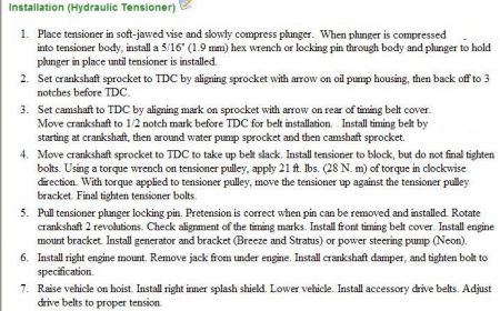

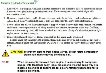

How to change a timing belt
Sunday, December 13th, 2009 AT 3:59 PM
BLUELIGHTNIN6
  • 16,542 POSTS
https://www.2carpros.com/forum/automotive_pictures/261618_Noname_1281.jpg
https://www.2carpros.com/forum/automotive_pictures/261618_Noname2_382.jpg
https://www.2carpros.com/forum/automotive_pictures/261618_Noname3_145.jpg
