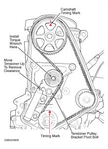

OK, broke a Timing belt on highway(@65mph)
I just replaced belt, when I re installed new one, I got #1 cylinder TDC, and put crank and cam gears with timing marks up and aligned on timing marks. But I cant get the car to start. Is it possible to be 180 out. Im good on old V8's, but these interferance motors are sort of confussing to me. Second, I didnt here and valves hitting pistons when it happened, is there a way to check them with out pulling the head off. Springs are all still intack, and valve stems are all still visible, my biggisest concern I guess is bent valve's.

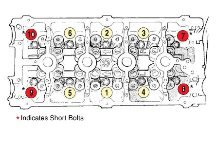

You need to make sure your timing marks are correct
start by checking and making sure timing marks are on
and if so do a compression test
https://www.2carpros.com/forum/automotive_pictures/99387_95neon_1.jpg
https://www.2carpros.com/forum/automotive_pictures/99387_95_neon_2.jpg
