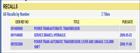

Also one other thing. It looks like you may have some recalls on your vehicle. The dealer may fix these for free. Please contact the dealer service department, give them the VIN number of your car and have them check on these to see if they apply to you.
https://www.2carpros.com/forum/automotive_pictures/248015_recall1_1.jpg
Tuesday, January 20th, 2009 AT 7:38 PM
