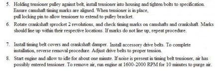

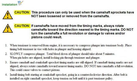

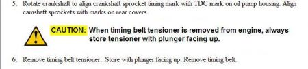

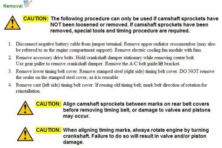

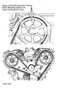

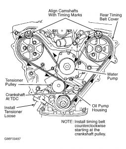

How to service timing belt and diagrams on procedure
