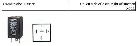

the turning signal lights go on and off then just stay's on without flashing anymore. I've changed the fuses and I know that the blubs don't need to be changed. What else could it be?

Did you replace the turn signal flasher?
https://www.2carpros.com/forum/automotive_pictures/55316_01intrepidflasher_1.jpg

Where is the flasher located?

Read my previous post. "Left side of dash, right of junction box" (fuse box at the end of the dash).
