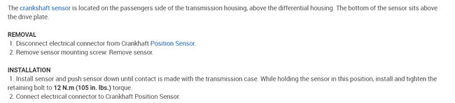

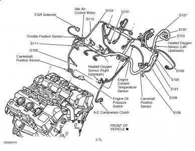

Where is the cam sensor and crank sensor on the car?
Tuesday, January 20th, 2009 AT 3:26 PM
17 Replies
  • 75,992 POSTS
The crankshaft sensor you are looking for is located on the passenger's side of the transmission housing, above the differential housing. The bottom of the sensor sits above the drive plate. Check out the diagrams (Below). Please let us know if you need anything else to get the problem fixed.

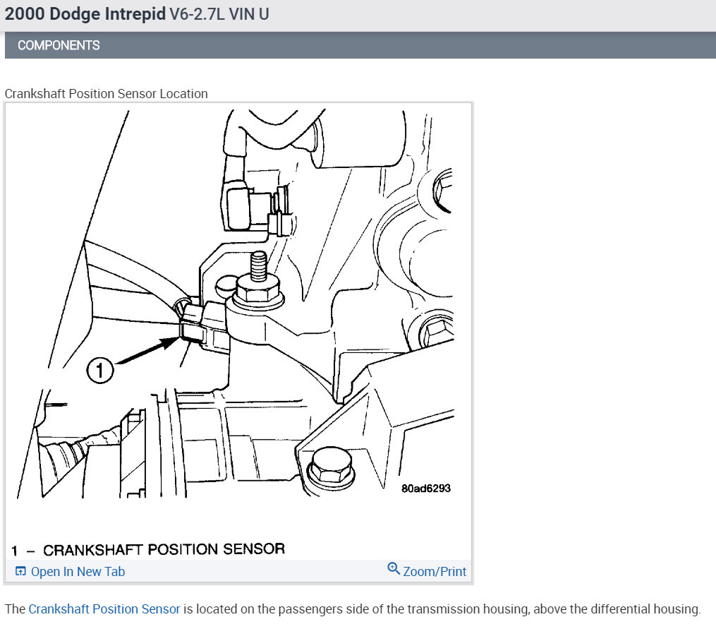

Engine light came on. Went to Auto Zone to have it put on machine. Machine said crank position sensor was malfunctioning. I baught one, but I don't know where it goes. Can you help?
+2
Wednesday, October 23rd, 2019 AT 1:47 PM (Merged)
BLUELIGHTNIN6
  • 16,542 POSTS
Your vehicle's crankshaft position sensor is located on the right side of the transmission housing.
2.7L shown, others similar
https://www.2carpros.com/forum/automotive_pictures/261618_Graphic_314.jpg

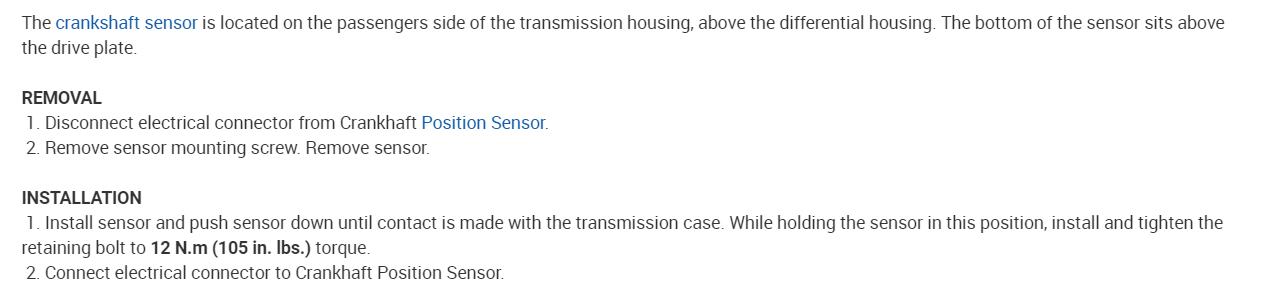

Will like to know specifily where is the position where the cranshaft is located to replace sensor.
Wednesday, October 23rd, 2019 AT 1:48 PM (Merged)
  • 110,192 POSTS
If you have a 3.2L or 3.5L, it on the passanger's side of the transmission housing above the differential.
Let me know if this helps.
