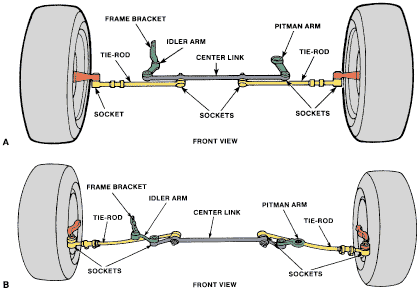

Needing to know, How to replace a inner tie rod on the passenger side?

Tie rod end are threaded to provide a means of adjusting toe, when a tie rod is replaced. measure the old tie rod assembly befor disassembling it. an approximate toe-in adjustment can be made to the new one prior to installation. when removing the old tie rod end count the number of turns it takes to remove it, then turn the new tie rod end onto its threads the same number of turns
https://www.2carpros.com/forum/automotive_pictures/420105_f4202_1.gif
