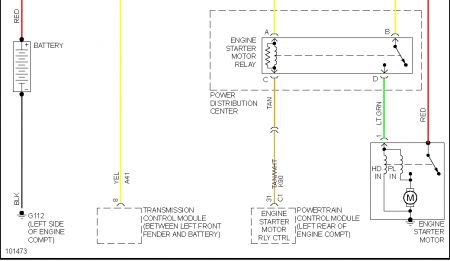

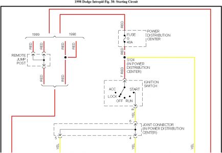

1998 Dodge Intrepid 6 cyl Four Wheel Drive Automatic
I need help locating the igniton harness for installing a remote car stater. Please.
