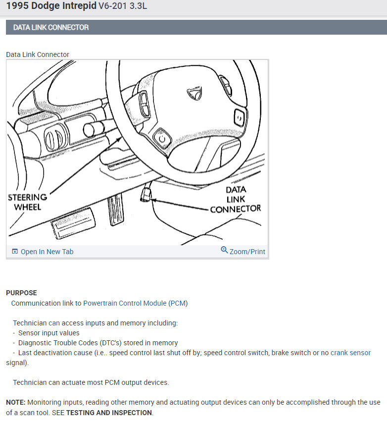

ALDL connector location please?

1995 DODGE INTREPID
Where is the computer connection?

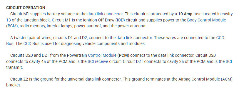

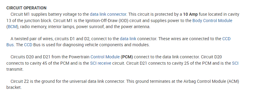

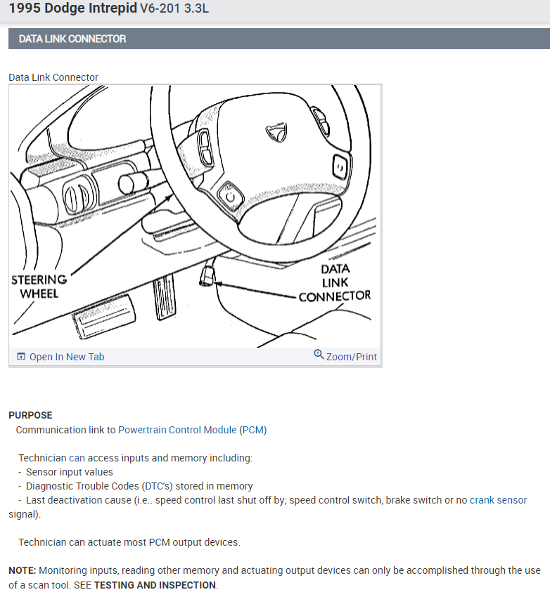

The data link connector for this vehicle is located on the right side of the throttle pedal. It is adjacent to the center console (see diagram below).
