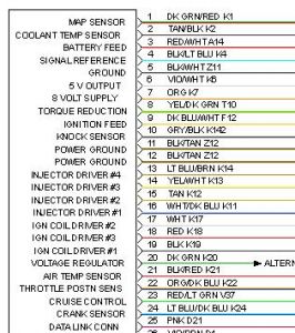

JDL
  • 16,098 POSTS
https://www.2carpros.com/forum/automotive_pictures/170934_intrepid_computer_connector_1.jpg
Pin 7 should be ref voltage. There are numerous sensors that use the same ground. I can't rule out that another sensor might be causing a problem?

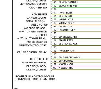

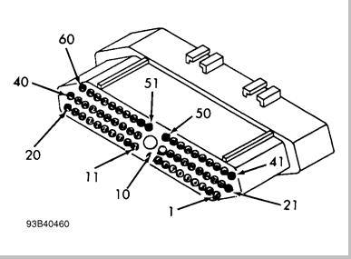

JDL
  • 16,098 POSTS
https://www.2carpros.com/forum/automotive_pictures/170934_dodge_intrepid_35_1_1.jpg
https://www.2carpros.com/forum/automotive_pictures/170934_dodge_intrepid35_2_1.jpg
https://www.2carpros.com/forum/automotive_pictures/170934_dodge_intrepid_35_3_1.jpg
Sorry about that, I had to magnify the page in order to make it readable. When I magnify, there is only small part of the page that is visible to copy. I had to copy in three sections. The autozone site has free wiring diagrams, you have to register the vehicle, it's free. With some dodge vehicles there is a dalalink connector under the hood, usually close to battery, it's a hookup for a scanner. I'll double check for your vehicle.

XEARO
  • 9 POSTS
Hey thanks for the diagram! Autozone provides wiring diagrams? Cool! That will help in the future. I think there is a datalink connector down there but the car is OBD1 (I think? I have scanned for codes in a few obd2 vehicles but in obd1 with a chrystler, you have to turn the key on and off a few times and it will blink the check engine light to signify codes. Well it doesnt, so either it really is obd2 or both computers are fried, or something else =)
i think I saw that datalink connector under there. If I did, I guess I could go borrow a scanner and check it out. The check engine light does not stay on however. So I bet there arre no codes stored.
Well I am going to check a few things based on that pinout. I appreciate it! You have definately been very helpful! I will continue to use this site in the future!
