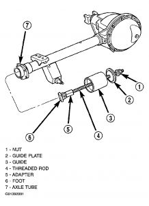

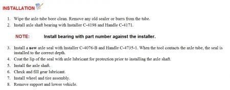

How do I replace the rear wheel hub in my 2002 dodge durango
Sunday, October 24th, 2010 AT 12:34 PM
BLUELIGHTNIN6
MECHANIC
16,542 POSTS
Sunday, October 24th, 2010 AT 7:18 PM
