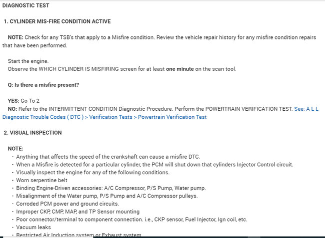

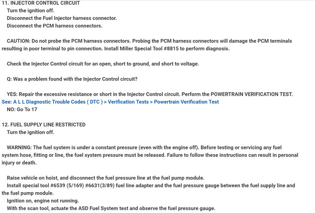

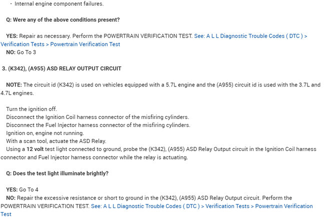

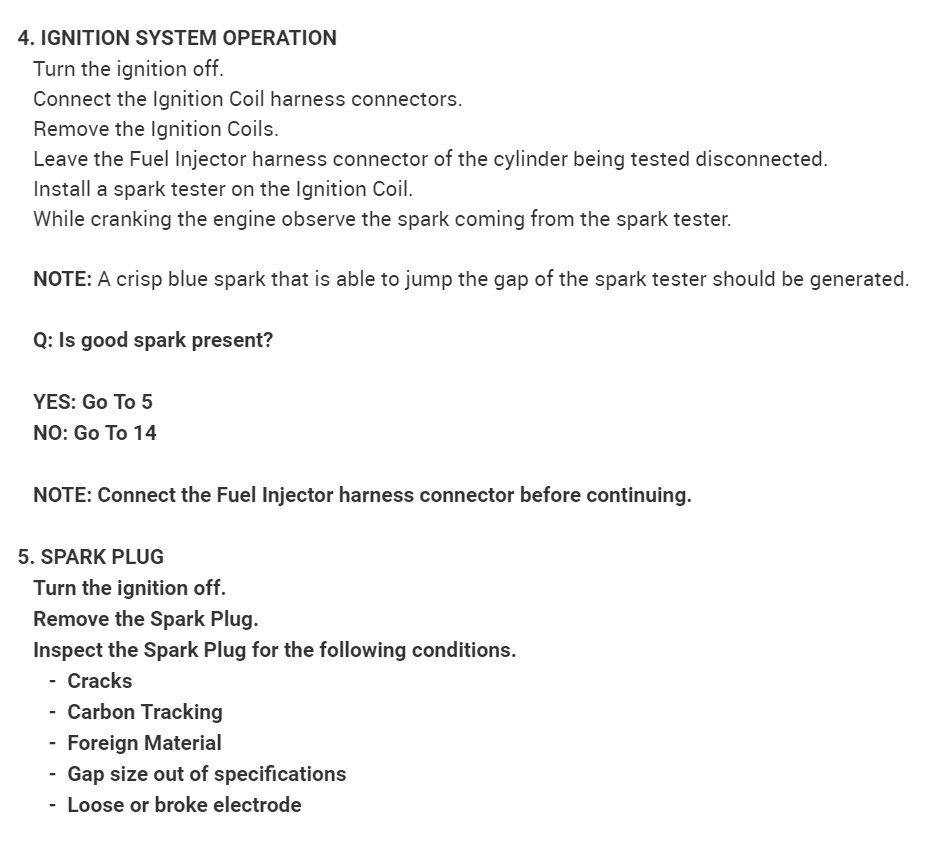

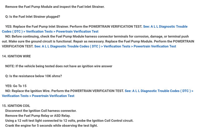

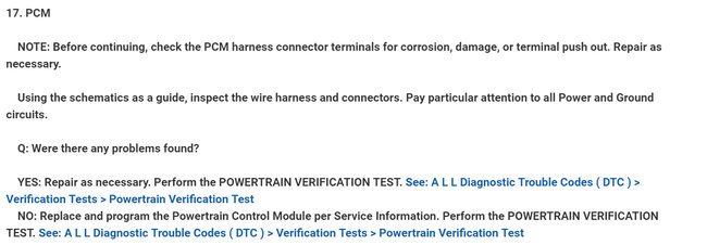

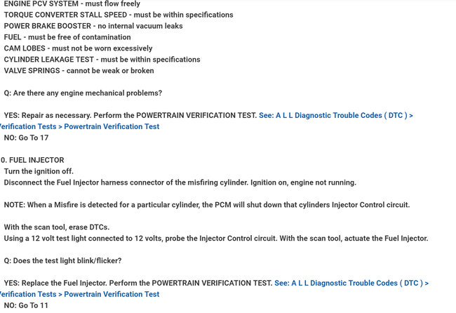

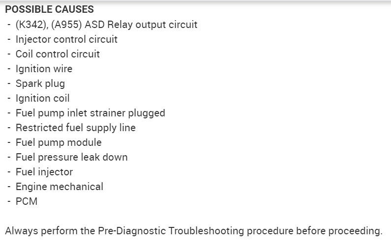

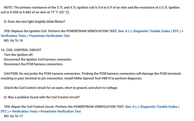

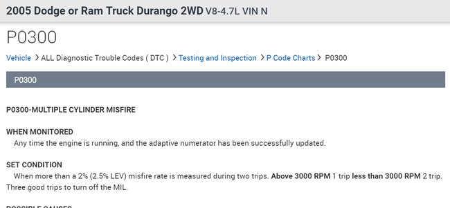

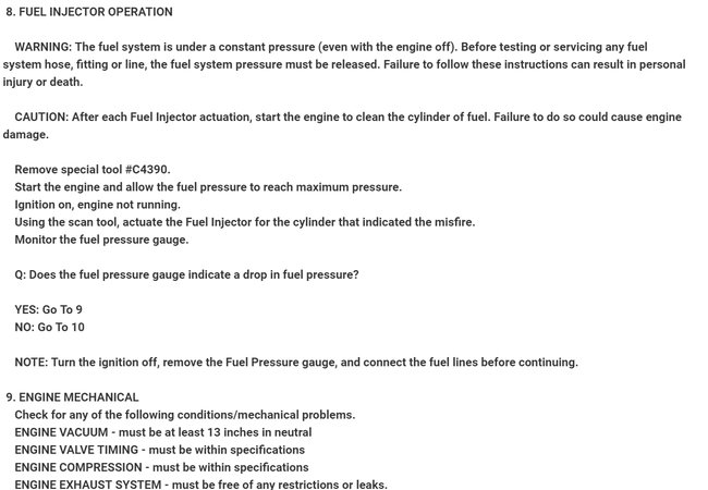

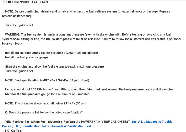

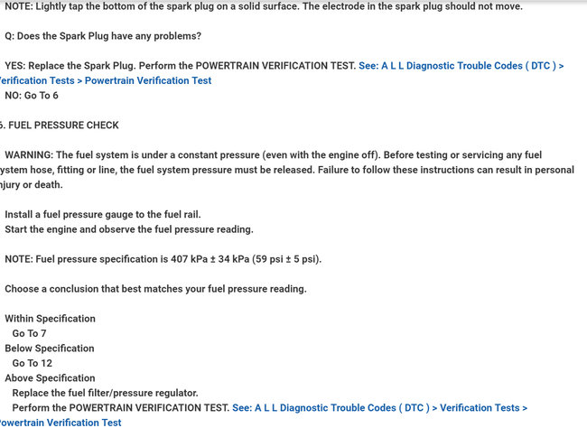

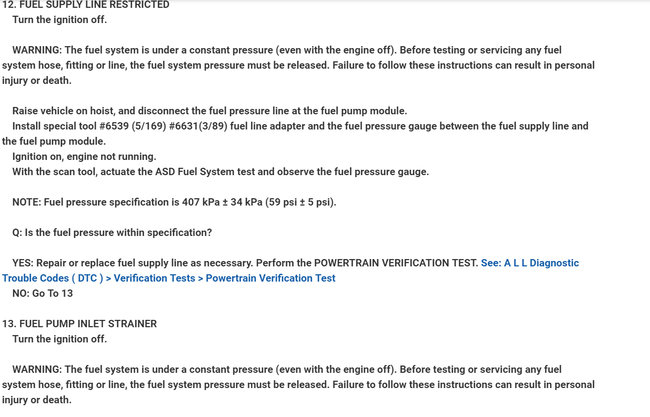

SCGRANTURISMO
  • 4,897 POSTS
It very well could have been water getting down into your spark plugs and causing your vehicle misfires. I have included in the diagrams below a troubleshooting flowchart for P0300, which is a generic DTC for random misfires, But it will apply to each cylinder individually as well. Please go through it and let us know what you find out.
Thanks,
Alex
2CarPros
