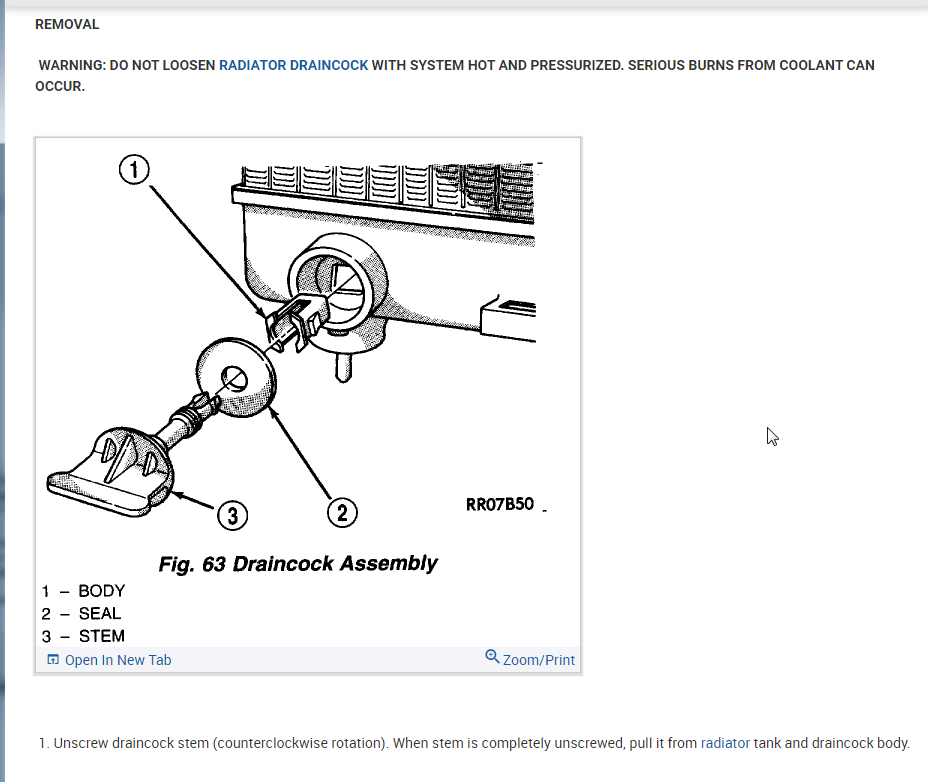

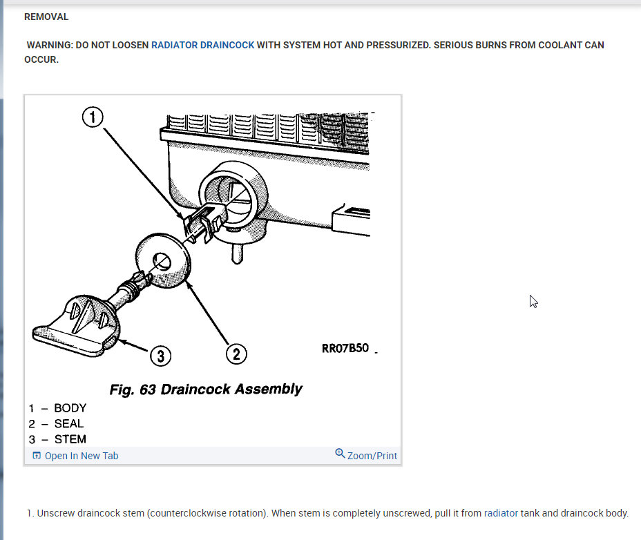

Where is the drain valve to drain the radiator?
Sunday, December 7th, 2008 AT 3:20 PM
MECHANIC
18,907 POSTS

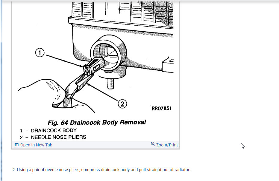

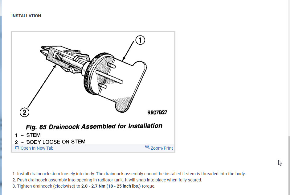

It is located at the bottom corner of the radiator. Here is a guide that give detail on how to do this and shows the location:
https://www.2carpros.com/articles/coolant-flush-and-refill-all-cars
Also, here is a video that will help as well:
https://www.youtube.com/watch?v=eklCKZIOd_0
Lastly I attached the process from the manual that will help as well.
