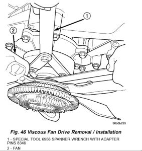

4. Remove upper radiator hose clamp and hose at radiator.
https://www.2carpros.com/forum/automotive_pictures/12900_wp1_5.jpg
https://www.2carpros.com/forum/automotive_pictures/12900_wp2_5.jpg

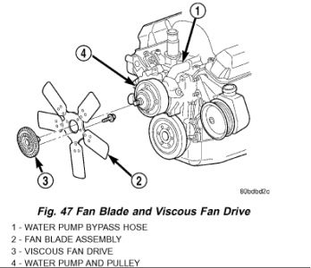

5. The thermal viscous fan drive is attached (threaded) to the water pump hub shaft. Remove fan/viscous fan drive assembly from water pump by turning mounting nut counterclockwise as viewed from front. Threads on viscous fan drive are RIGHT HAND. A Snap-On 36 MM Fan Wrench (number SP346 from Snap-On Cummins Diesel Tool Set number 2017DSP) and Special Tool 6958 Spanner Wrench with Adapter Pins 8346 can be used. Place Special Tool 6958 Spanner Wrench onto the water pump pulley with Adapter Pins 8346 inserted into the holes on the pulley to prevent pulley from rotating. Do not attempt to remove fan/viscous fan drive assembly from vehicle at this time.
6. If water pump is being replaced, do not unbolt fan blade assembly from thermal viscous fan drive.
7. Remove fan shroud attaching hardware (two bolts at bottom-two clips at top).
8. Remove fan shroud and fan blade/viscous fan drive assembly from vehicle as a complete unit.
9. After removing fan blade/viscous fan drive assembly, do not place thermal viscous fan drive in horizontal position. If stored horizontally, silicone fluid in viscous fan drive could drain into its bearing assembly and contaminate lubricant.

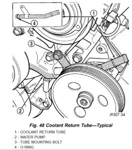

12. Remove heater hose clamp and heater hose from heater hose coolant return tube.
https://www.2carpros.com/forum/automotive_pictures/12900_wp3_3.jpg
13. Loosen heater hose coolant return tube mounting bolt and remove tube from water pump. Discard the old tube O-ring.
14. Remove seven water pump mounting bolts.
15. Loosen clamp at water pump end of bypass hose. Slip bypass hose from water pump while removing pump from vehicle. Discard old gasket. CAUTION: Do not pry water pump at timing chain case/cover. The machined surfaces may be damaged resulting in leaks.
