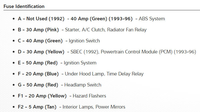

Can you please give me the fuse panel location and identification?
Friday, March 12th, 2010 AT 5:25 PM
17 Replies
BMRFIXIT
  • 19,053 POSTS
Here is a guide to help you test the fuses with diagrams below to show you the fuse panel.

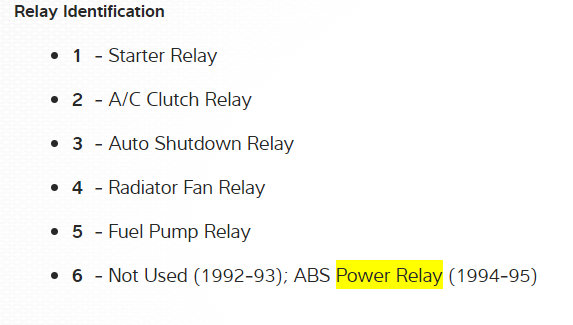

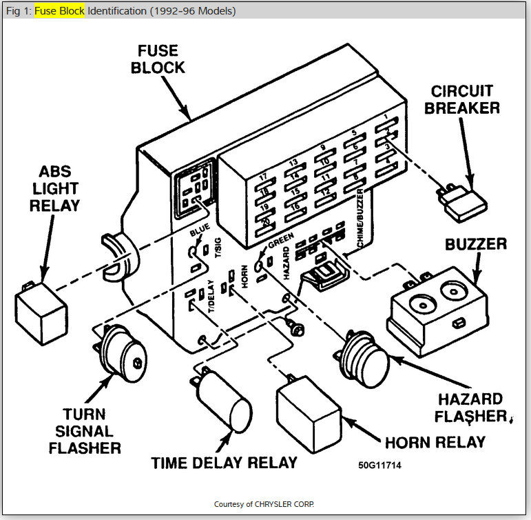

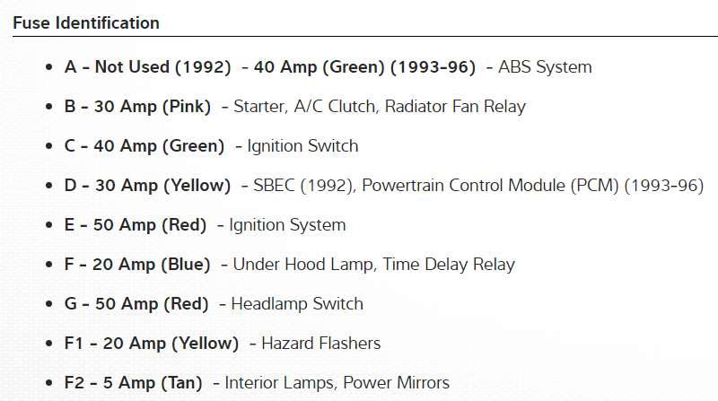

JECCO8504
  • 1993 DODGE DAKOTA

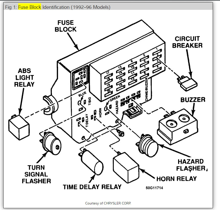

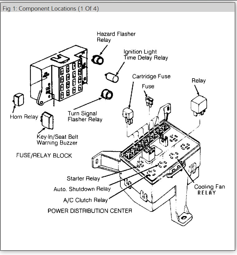

Where is the fusebox?
Saturday, September 19th, 2020 AT 2:11 PM (Merged)

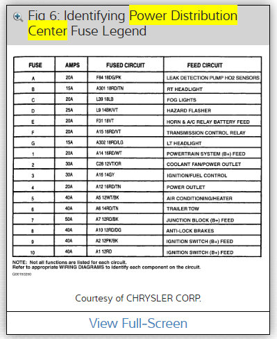

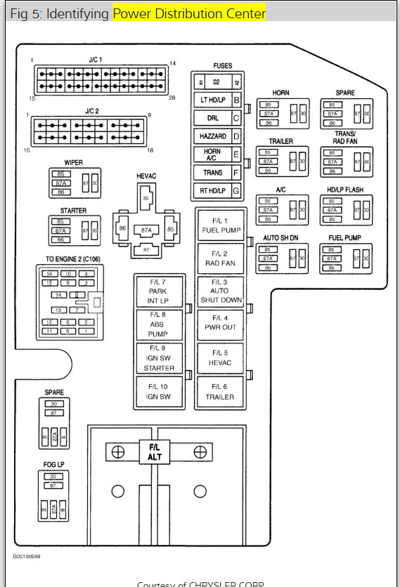

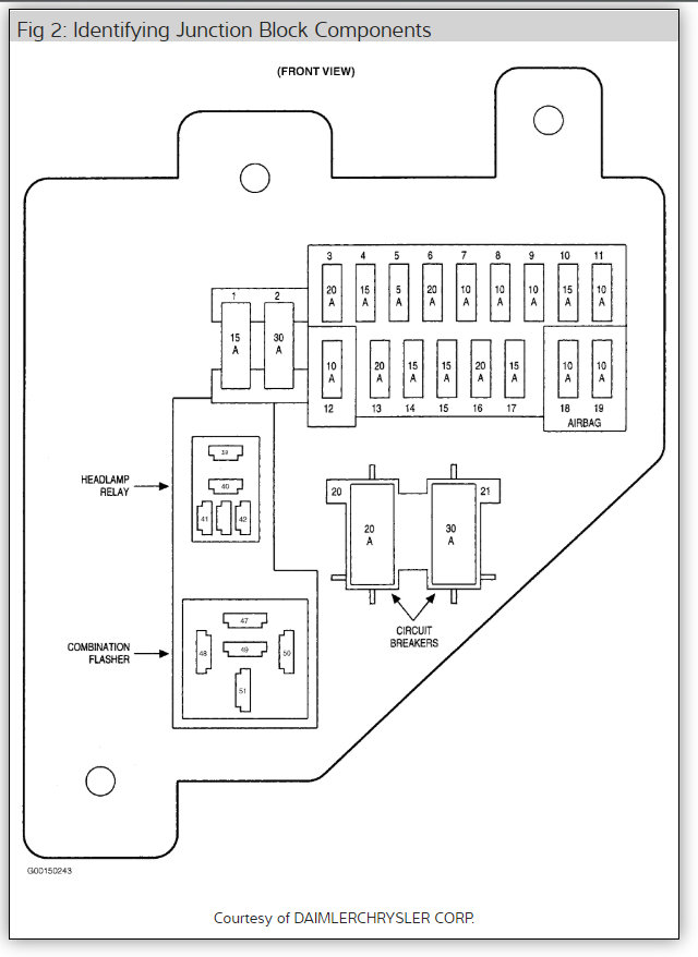

CARADIODOC
  • 34,489 POSTS

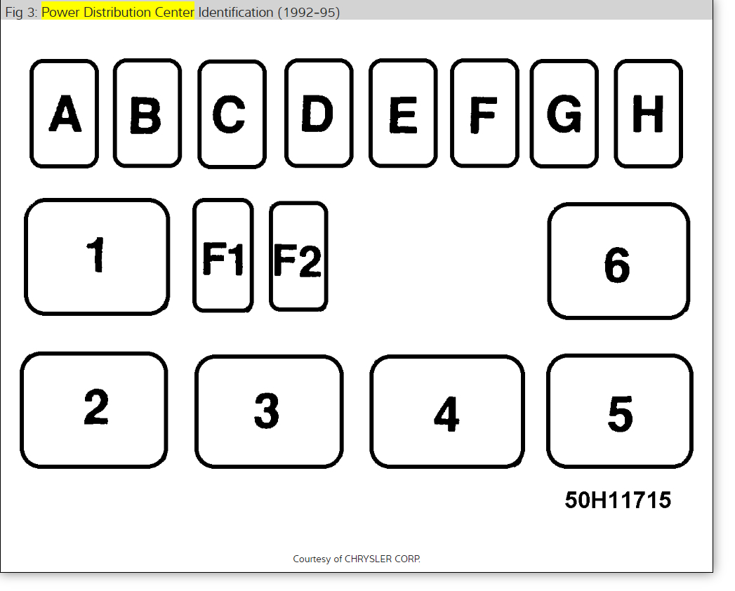

Power Distribution Center is under the hood right behind the washer fluid reservoir. Junction Box is near the steering column and brake pedal. Check out the diagrams (Below). Please let us know if you need anything else to get the problem fixed.

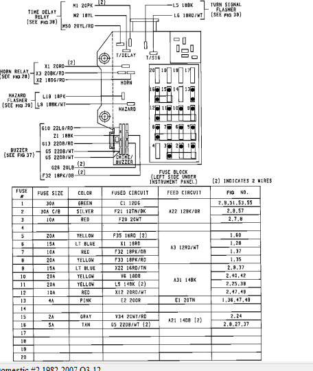

MDCAUT
  • 1992 DODGE DAKOTA
I need to see the fuse panel diagrams can you please get them for me?

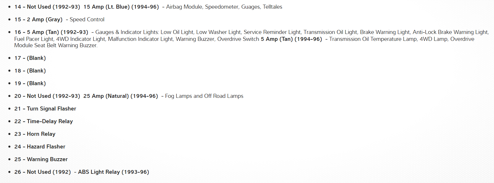

DR LOOT
  • 2,311 POSTS

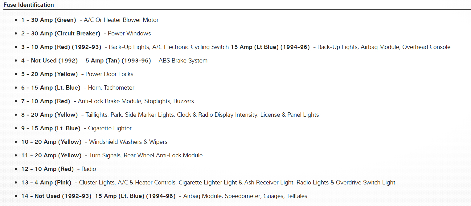

Here is a guide to help you test the uses and the fuse panel locations and diagrams below.

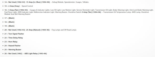

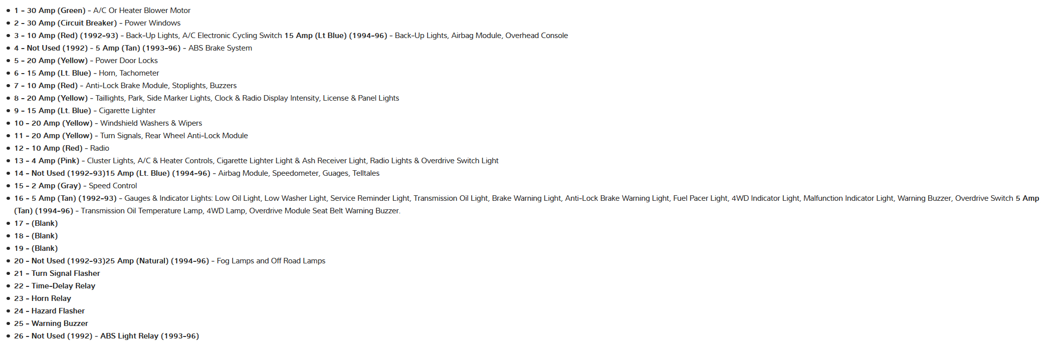

Fuse Identification
1 - 30 Amp (Green) - A/C Or Heater Blower Motor
2 - 30 Amp (Circuit Breaker) - Power Windows
3 - 10 Amp (Red) (1992-93) - Back-Up Lights, A/C Electronic Cycling Switch 15 Amp (Lt Blue) (1994-96) - Back-Up Lights, Airbag Module, Overhead Console
4 - Not Used (1992) - 5 Amp (Tan) (1993-96) - ABS Brake System
5 - 20 Amp (Yellow) - Power Door Locks
6 - 15 Amp (Lt. Blue) - Horn, Tachometer
7 - 10 Amp (Red) - Anti-Lock Brake Module, Stoplights, Buzzers
8 - 20 Amp (Yellow) - Taillights, Park, Side Marker Lights, Clock & Radio Display Intensity, License & Panel Lights
9 - 15 Amp (Lt. Blue) - Cigarette Lighter
10 - 20 Amp (Yellow) - Windshield Washers & Wipers
11 - 20 Amp (Yellow) - Turn Signals, Rear Wheel Anti-Lock Module
12 - 10 Amp (Red) - Radio
13 - 4 Amp (Pink) - Cluster Lights, A/C & Heater Controls, Cigarette Lighter Light & Ash Receiver Light, Radio Lights & Overdrive Switch Light
14 - Not Used (1992-93) 15 Amp (Lt. Blue) (1994-96) - Airbag Module, Speedometer, Guages, Telltales
15 - 2 Amp (Gray) - Speed Control
16 - 5 Amp (Tan) (1992-93) - Gauges & Indicator Lights: Low Oil Light, Low Washer Light, Service Reminder Light, Transmission Oil Light, Brake Warning Light, Anti-Lock Brake Warning Light, Fuel Pacer Light, 4WD Indicator Light, Malfunction Indicator Light, Warning Buzzer, Overdrive Switch 5 Amp (Tan) (1994-96) - Transmission Oil Temperature Lamp, 4WD Lamp, Overdrive Module Seat Belt Warning Buzzer.
17 - (Blank)
18 - (Blank)
19 - (Blank)
20 - Not Used (1992-93) 25 Amp (Natural) (1994-96) - Fog Lamps and Off Road Lamps
21 - Turn Signal Flasher
22 - Time-Delay Relay
23 - Horn Relay
24 - Hazard Flasher
25 - Warning Buzzer
26 - Not Used (1992) - ABS Light Relay (1993-96)
Cheers

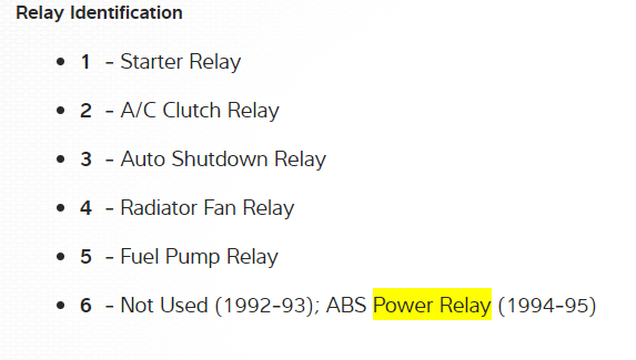

ERKMAN34
  • 1992 DODGE DAKOTA
  • V8
  • 4WD
  • 200,000 MILES

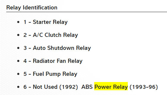

When I turn the ignition key into the on position the fuse box under the hood on the drivers side makes a clicking noise. The truck will not start until the clicking noise stops. On colder days I have to wait for over twenty minutes for the clicking noise to stop. Anyone know whats going on here? Thanks.
  • 110,194 POSTS
It sounds like a bad relay. If you feel the top of the relays, you should be able to feel the clicking. Try replacing that relay. You should be able to switch it out with another one from the box. Just make sure the part number is the same.
Let me know if you have questions.
ERKMAN34
Yes, I can feel the clicking noise when I put my finger on the auto shut down relay and the fuel pump relay. When I pull both of them out the noise stops. I have switched the relays around (all have same part number) and still the clicking noise was still happening. I also bought new relays and still nothing, the fuse box still makes the clicking noise. I live in Massachusetts, so now the truck will not start at all because it is so cold. The fuse box still starts to click but it will not stop now because it is so cold.
Any other ideas? Thanks.

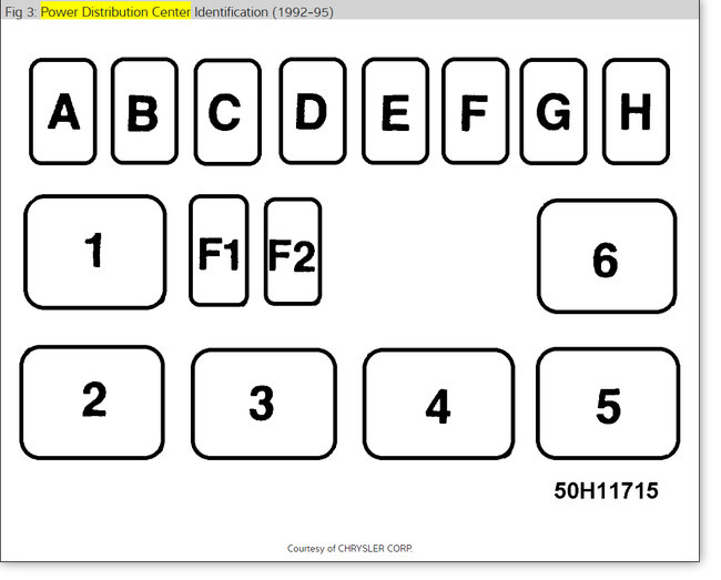

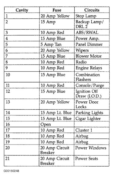

I need a diagram of the fuse box
SEVAG P
  • 406 POSTS
Hello thanks for using 2CarPros. Check the attached picture for fuse box diagram. Check out the diagrams (Below). Please let us know if you need anything else to get the problem fixed. Thank you
