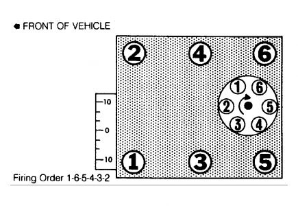

Docfixit thanks for your response before. A 3.9l what should the pressure from the fuel pump be? And is there a difference in the firing order from a 3.0? Thanks again Sky Dog
Wednesday, November 10th, 2010 AT 12:24 PM
DOCFIXIT
  • 18,828 POSTS
Hi
Timing not adjustable controled by computer
Fuel pressure 14.5 psi
firing order
https://www.2carpros.com/forum/automotive_pictures/198357_Graphic_706.jpg
