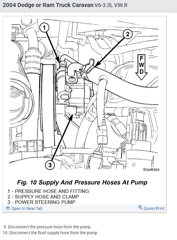

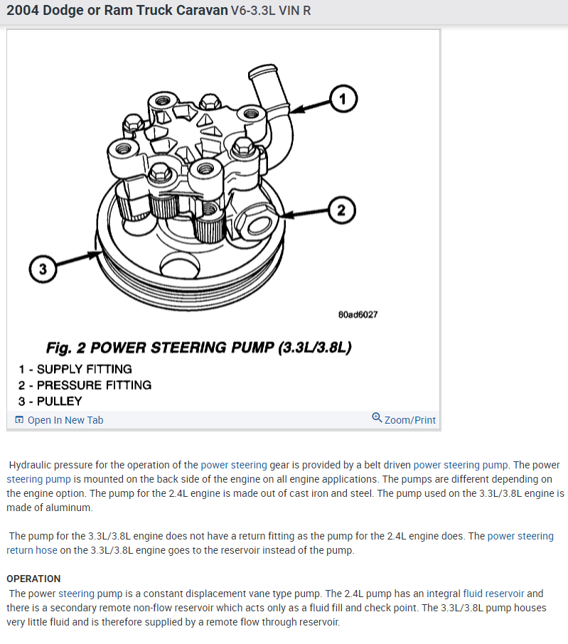

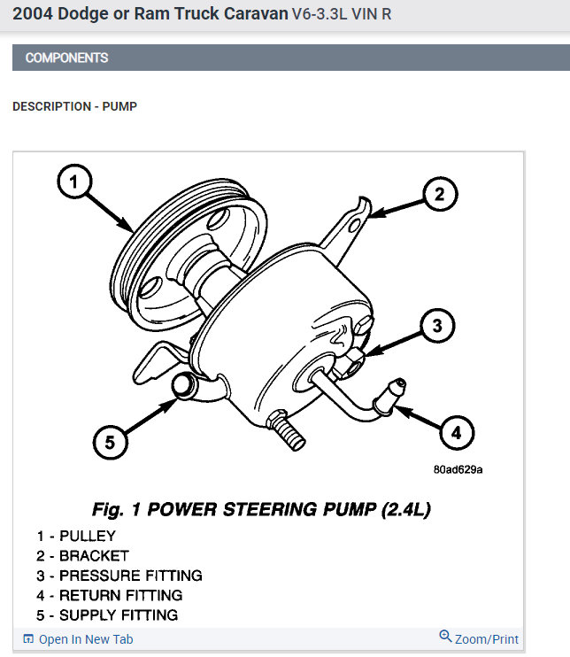

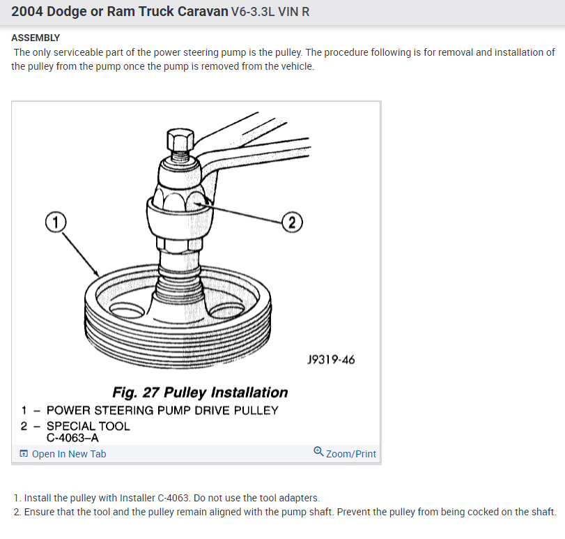

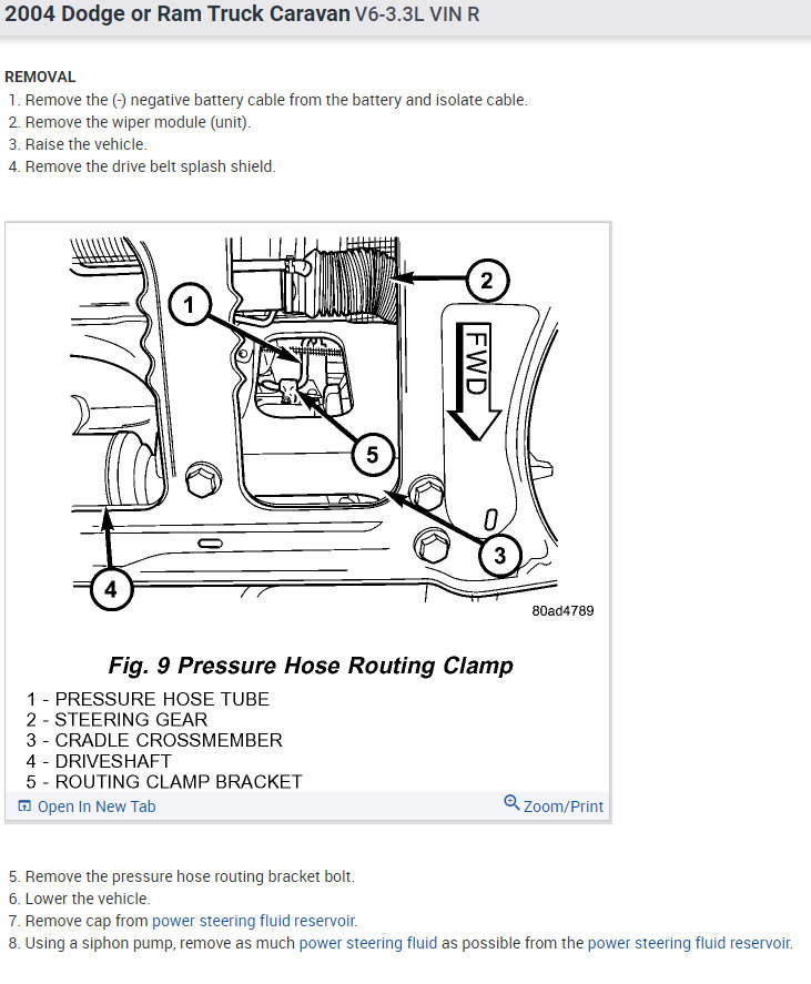

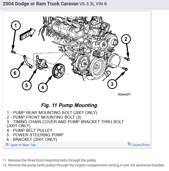

That noise is likely from the power steering pump.
The pump can make the noise when it is low on fluid or as the pump ages the internals will wear off and many times it will make noise when you put load (turn the wheel) on the pump.
First check the fluid level and make sure it is correct.

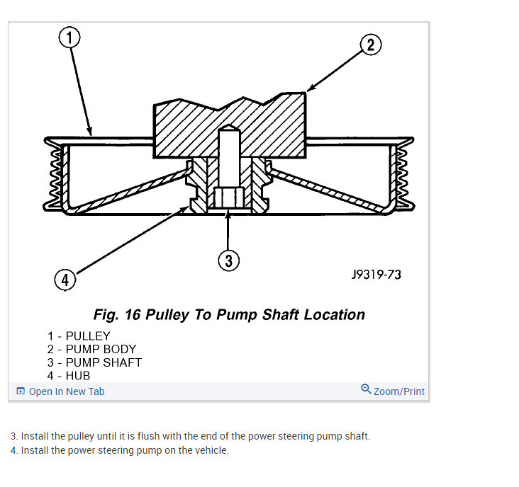

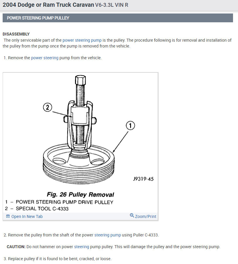

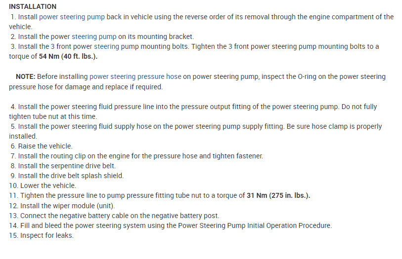

In order to change the pump you will have to remove the drive belt. After the pump removal you will have to remove the pulley from the pump. Removing the pulley requires a special tool. Which can be rented from you local auto parts store.
Here are some helpful articles:
https://www.2carpros.com/articles/power-steering-problems
https://www.2carpros.com/articles/how-to-replace-a-power-steering-pump
https://www.2carpros.com/articles/remove-reinstall-power-steering-pulley
