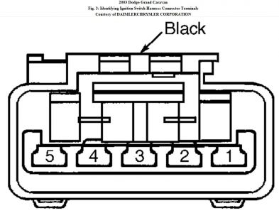

This could be the ignition switch, not the key(cylinder) but the plastic part the harness plugs into, or your computer(pcm), test the switch like this:
Ignition switch 1. Remove ignition switch. See ignition switch and lock cylinder under removal and installation. Check continuity between ignition switch terminals no. 3 and 5 with ignition switch in start and run positions. See fig. 3 . If continuity exists, go to next step. If continuity does not exist, replace ignition switch. 2. Check continuity between ignition switch terminals no. 4 and 5 with ignition switch in start position. If continuity exists, go to next step. If continuity does not exist, replace ignition switch. 3. Ignition switch sends multiplexed commands to body control module (bcm). Use scan tool to diagnose affected system(s). For diagnosis and repair, see body control modules - caravan, town & country, & voyager article. For ignition switch circuit function, see ignition switch circuit functions table.
https://www.2carpros.com/forum/automotive_pictures/62217_IGN_SW_2.jpg
https://www.2carpros.com/forum/automotive_pictures/62217_IGN_SW_Chart_1.jpg
+1
Friday, July 20th, 2018 AT 3:45 PM
RENZYB
  • 8 POSTS
So funny thing, I did that test and pins 4&5 did not have continuity so I replaced the ignition switch. After replacing the switch I started the vehicle and it immediately shut off and now I am right back to where I was with a no start issue. This is frustrating.
