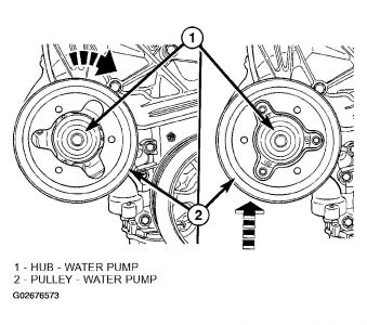

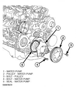

https://www.2carpros.com/forum/automotive_pictures/99387_caravan_water_pump_3338position_pully_1.jpg
https://www.2carpros.com/forum/automotive_pictures/99387_caravan_water_pump_3338_1.jpg

no need for engine to be lifted you have to remove pulley out
line it up like the pic and remove it

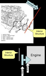

Thanks for the photos, but unfortunately that doesn't solve my problem. I did get the pully removed from the hub, but there is not enough clearance to the passenger side of the car to get it out. The interior structure of the engine compartment gets in the way. I was able to position the pulley as shown in the diagram, but that only allows you to put it over the hub and onto the shaft, not take it off which requires movement in the other direction. I was also able to unbolt the pump, but the same interior structure was in the way, so I could not pull it out of the ngine (to the passenger side) far enough for the impeller to clear the engine...therefore I couldn't take it off.
See photo for explanation of clearance issue. I tried to draw the front view to show the clearance problem...
