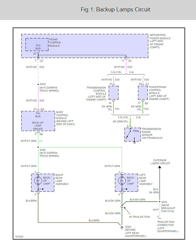

Both backup lights out
CRIP54
  • 2003 DODGE CARAVAN
  • 4 CYL
  • FWD
  • 42,000 MILES
I am trying to find out what might have caused both backup lights to quit working? All other lights are working in the back. (Taillights, brakes, turn signals) I looked in the fuse box next to the battery under the hood, even though I could not see a fuse specific to those lights, and none were burned out.
Any help would be appreciated.

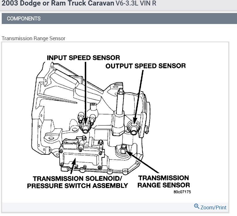

Hi there,
I would check the reverse light switch (range sensor) on the transmission. I will post a picture below. Please use this guide to test through the switch to make sure it is the problem.
Use this reverse light wiring diagram to help you. Check out the diagrams (Below). Please let us know what happens.
Cheers, Mark (mhpautos)
+2
Sunday, May 25th, 2008 AT 10:35 PM
CRIP54
Thanks for the help. I used the guides and you were right the switch/sensor was bad I got a new one for $54.99 and the problem is all fixed. :) I love this site.

Where is the reverse light switch on a 2003 Caravan?
Sunday, August 26th, 2018 AT 3:55 PM (Merged)
JDL
  • 16,098 POSTS
Back-up lite switch, at rear of transaxle. Sorry for the late post.
