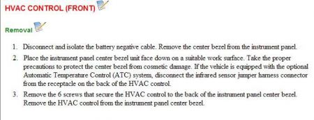

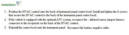

How do you get to and replace temp control module on 2002 Grand Caravan?

Does it go by a different name may be
what does it do and or what is the problem
