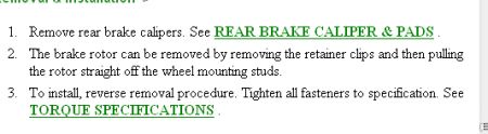

Whats the trick to getting the rear rotors off my 2002 grand caravan? Can't seem to get them to release.

I GOT NEW ROTORS. I HAVE THE REAR CALIPERS OFF. THE E-BRAKE DISCONNECTED, BUT INSIDE SOMETHING THAT SEEMS LIKE A PAD IS GRABBING IT LIKE A DRUM BRAKE WOULD. DOES THAT MAKE SENSE?

Take a look at this and see if it is similar to your configuration

KRUNS
YEP, THATS PRETTY MUCH IT. CALIPER MOUNTS ARE A LITTLE DIFFERENT, BUT SAME CONCEPT.

http://www.2carpros.com/forum/automotive_pictures/88091_ScreenHunter_01_Oct_19_1546_1.jpg

You do know that the caliper and caliper retainer clips have to be removed before you can take that rotor off, there cant be anything over that rotor
