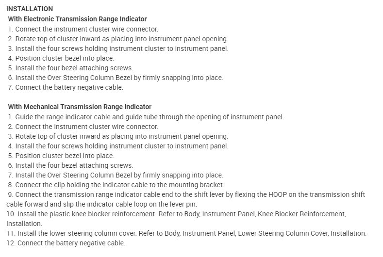

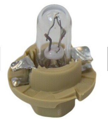

It sounds like the bulbs that illuminates the gauge are burning out. There are several bulbs that are installed at the back of the panel, which helps illuminate the gauge.
Over time they can burn out and will need to be replaced.

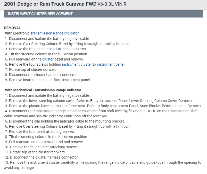

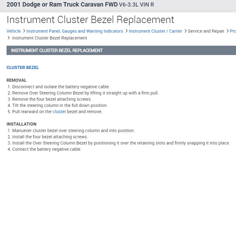

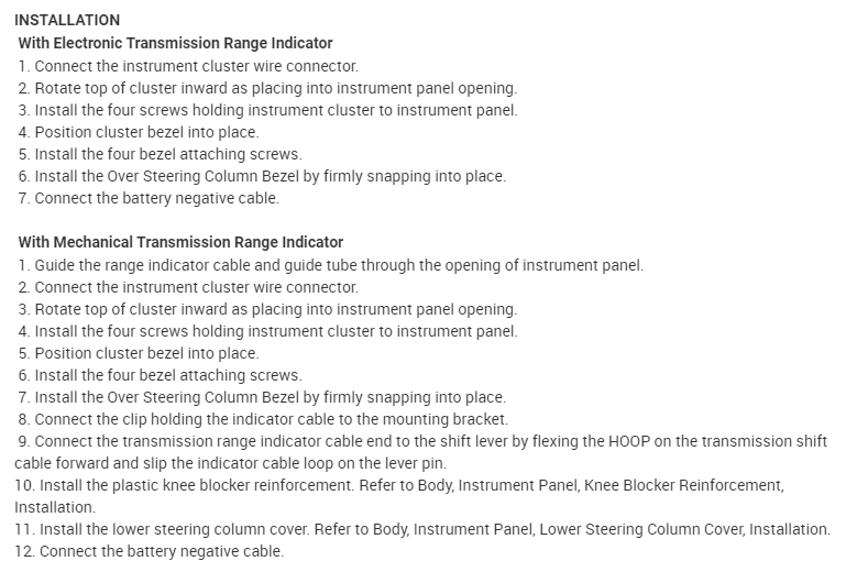

In order to replace those bulbs, you will have to remove the gauge cluster. This can be done by first removing the trim around the gauge cluster. Then the taking off the mounting screws at the edges of the cluster.
The bulbs will just twist out of the back panel (see picture).
