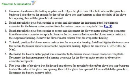

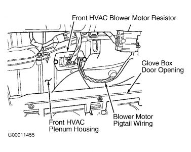

Where is it, how to change
Wednesday, October 21st, 2009 AT 6:23 PM
BLUELIGHTNIN6
  • 16,542 POSTS
https://www.2carpros.com/forum/automotive_pictures/261618_Noname_1096.jpg
FIG. 33
https://www.2carpros.com/forum/automotive_pictures/261618_Graphic_202.jpg
