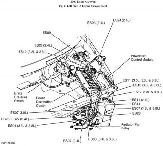

Can you post a picture where the PCM is located

PCM = Powertrain Control Module in the diagram, at left side of engine compartment.
https://www.2carpros.com/forum/automotive_pictures/192750_EngineComponent00CaravanFig02_1.jpg

EFREN79
Thanks for your help. As I mentioned, I'm disabled and have to depend on people to help me. Sorry I took long to reply.
My cousins van is a 2000 Chrysler Grand Voyager 3.3L
The engine looks identical.
Will it be okay to swap the PCM?

It is ok, you can reply at your convenience.
If the PCM part number are the same then a swap is possible otherwise it would not work.

EFREN79
Sorry for the late reply. It was the PCM. Thanks guys!
