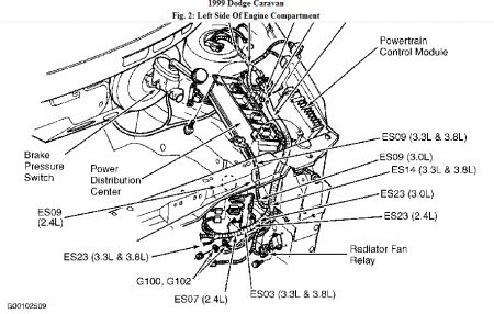

Where is the cooling (radiator) fan relay on a 1998 Dodge Grand Caravan?
Monday, November 26th, 2018 AT 11:24 AM (Merged)
  • 75,992 POSTS

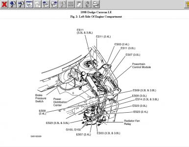

Cooling Fan Relay Location
Radiator Fan Relay Mounted On Left Front Frame Rail
https://www.2carpros.com/forum/automotive_pictures/12900_r_5.jpg
https://www.2carpros.com/forum/automotive_pictures/12900_r1_3.gif

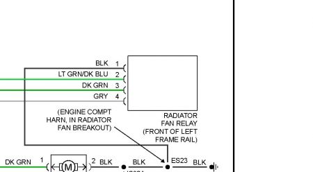

Check fuse no.4 40amp also see below for relay location
https://www.2carpros.com/forum/automotive_pictures/12900_fan_relay_6.jpg

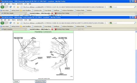

Where is the cooling fan relay located
Sunday, July 14th, 2019 AT 12:17 PM (Merged)
SATURNTECH9
  • 30,869 POSTS
https://www.2carpros.com/forum/automotive_pictures/416332_2006_dodge_caravan_cooling_fan_relay_part2_1.jpg
There you go.
JACKPAT
I cannot read the drawing you. Please send a clearer drawing.
+2
SATURNTECH9
  • 30,869 POSTS
Sorry about that some of the image's are hard to post clear I emailed you the diagram hopefully you can read that one.

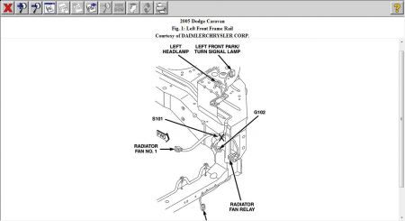

Its at top left front frame rail
https://www.2carpros.com/forum/automotive_pictures/12900_fan_relay_8.jpg
