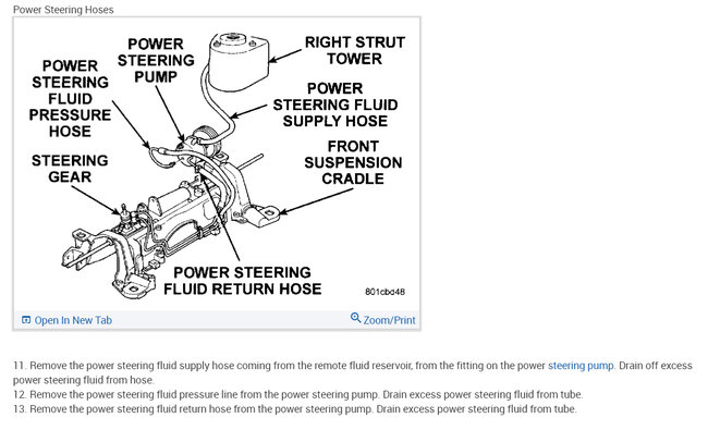

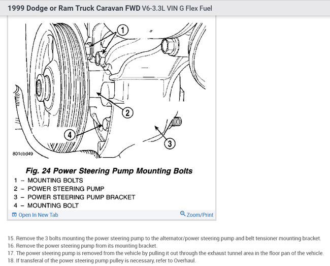

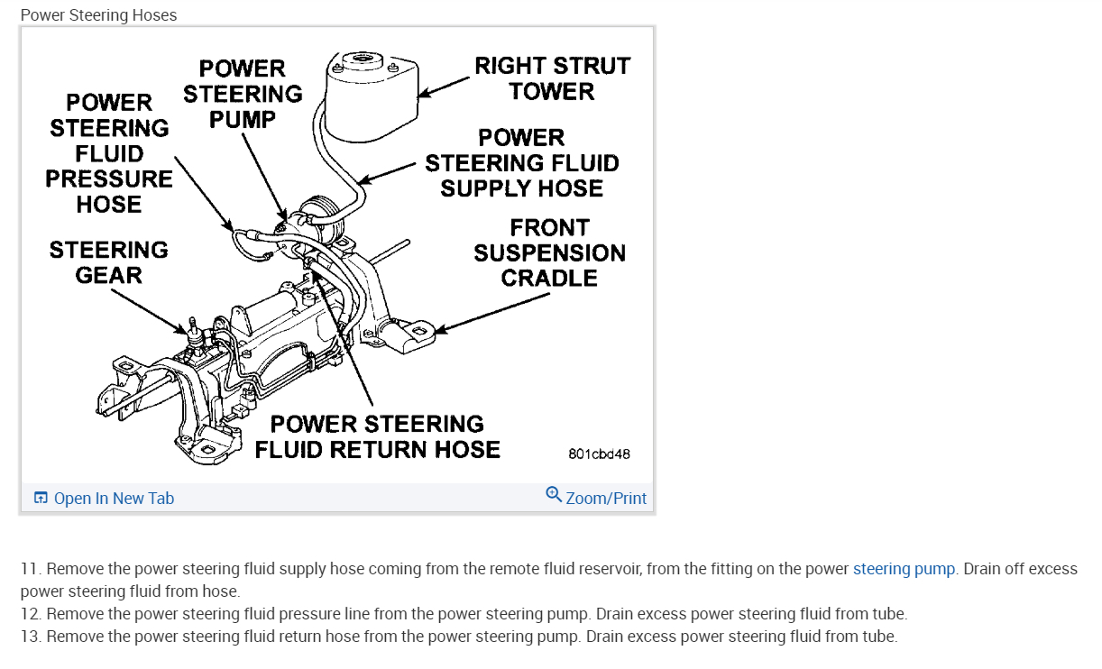

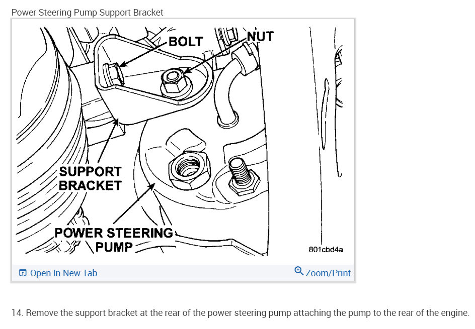

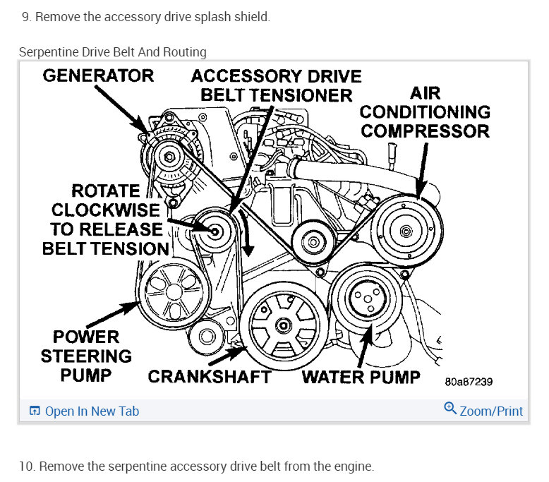

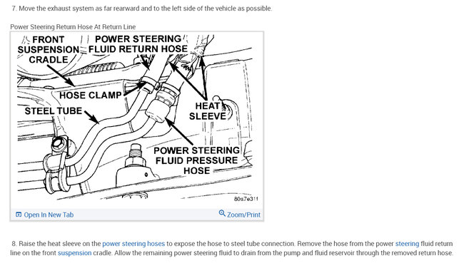

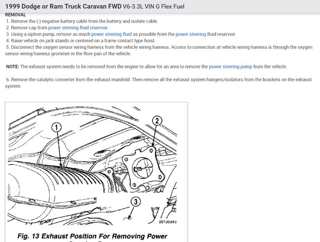

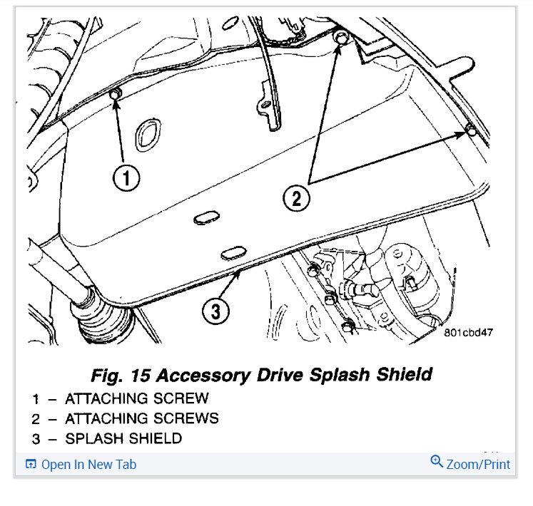

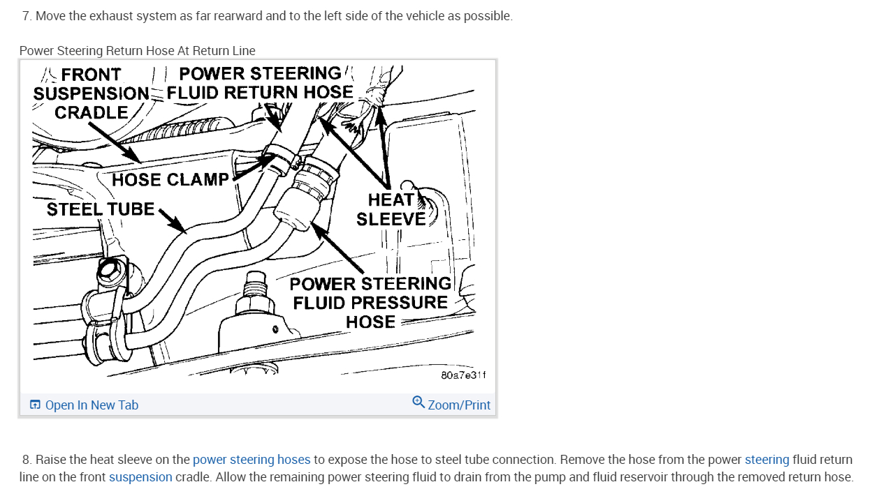

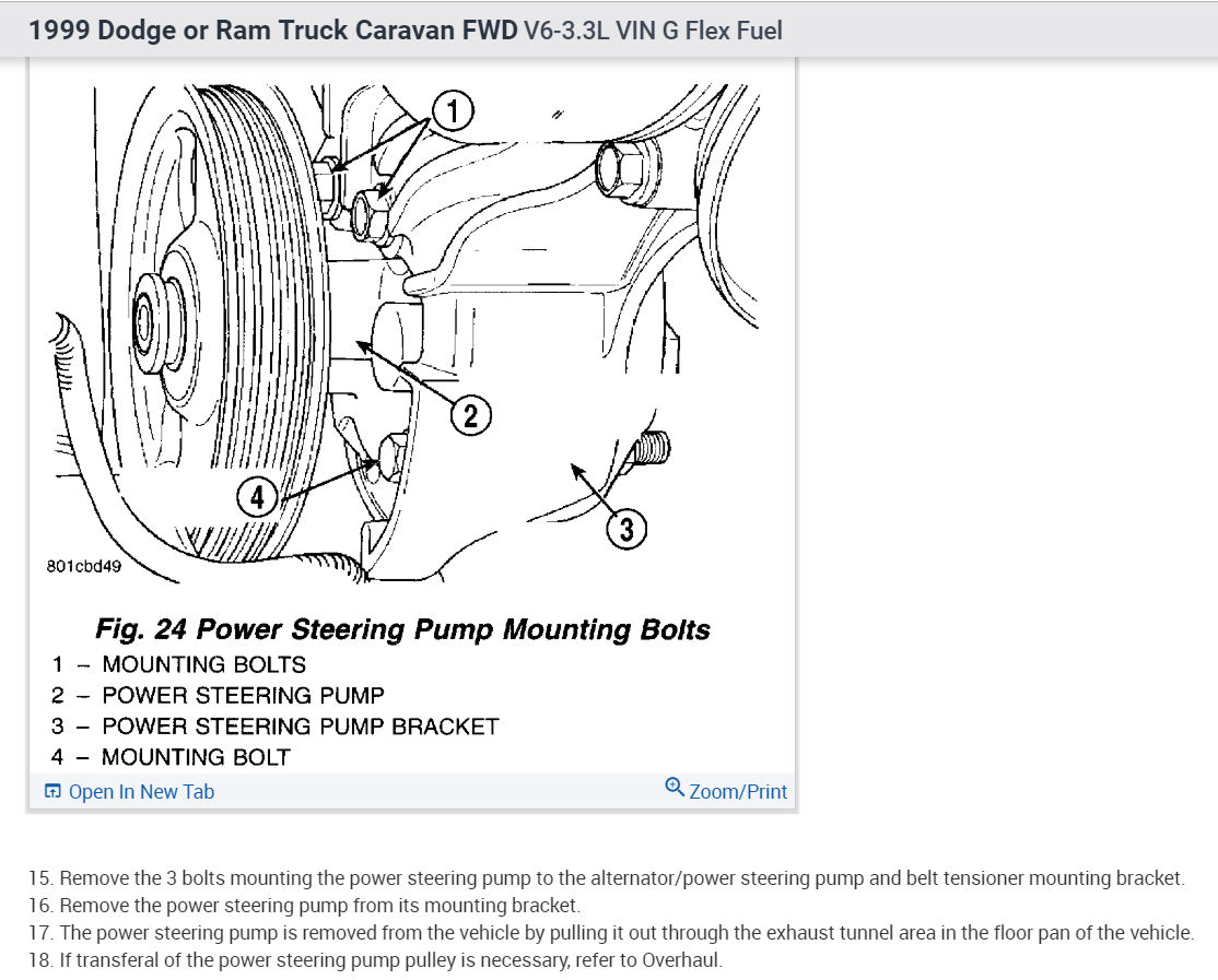

When this problem occurs 9 times out of 10 it is the pump not doing it job. here is a guide to help walk you through the repair with diagrams below to show you on your car:
https://www.2carpros.com/articles/how-to-replace-a-power-steering-pump
