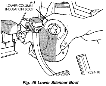

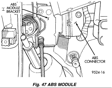

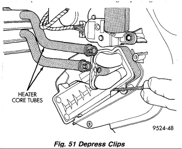

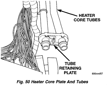

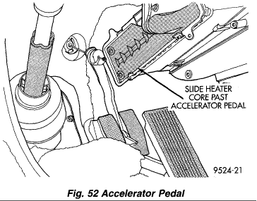

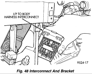

how can i take off the old heater core from my van do i nead to remove the hole dash bore or can i take it off from one side?

Hello - I have attached the removal and installation for your review. I hope this helps. If you do need to get back with me please let me know if this is just a Caravan, or a ES, LE, or SE or if it is a Grand Caravan ES, LE, or SE. Also the engine size in liter and the 8th digit of the VIN. Front Heater Core Notes REMOVAL Drain coolant system. Remove left side lower column cover. Remove steering column assembly.

Remove ABS module, bracket and wiring.

Remove I/P to body harness interconnect and bracket

Remove lower silencer boot at base of steering shaft. Pinch off heater lines under the hood.

Remove heater core cover. Insert a small amount of towels under the heater core tubes. Remove heater core plate and tubes.

Depress heater core retaining clips.

Pull up on accelerator pedal and slide heater core past. Depress brake pedal and remove heater core from HVAC housing. INSTALLATION For installation, reverse the above procedures. Install screws to retain heater core in housing. Replace heater core tube inlet 0-rings. Tighten heater core tube retaining plate to 2 to 4 NM (18 to 36 in. lbs.) torque .
