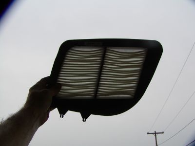

I wouldn't use brake clean, may damage sensors.
Get a can of intake cleaner. With the snorkel off, use a bottle brush to scrub it out in conjuction with the spray. When you get the deposits off, start the engine and run the idle up by hand and spray the the remainder of the can into it with the idle raised.
Get 3 cans of seafoam. Pour one into the tank next time you fill up. Add a can every other fill up and I think you'll see a difference. More isn't better, so make sure the tank is full and only go the three cans.
Check your air filter while your there too.
https://www.2carpros.com/forum/automotive_pictures/30961_dirty_1.jpg
https://www.2carpros.com/forum/automotive_pictures/30961_clean_2.jpg
I hope this was your solution.
