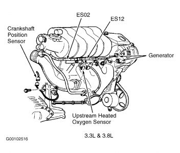

Check ASD relay
mark it and switch with a similar one
I would also suspect crank sensor
