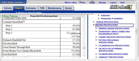

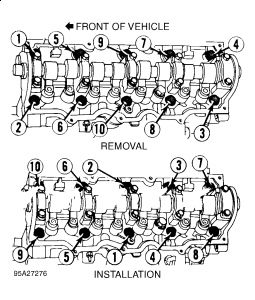

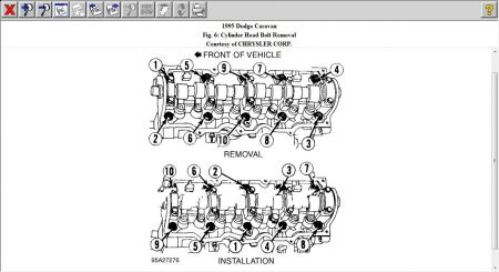

What are the torque specs for head bolts?

Here you go Sir, Tighten bolts in seq 1-3

Cylinder head bolts
torque specifications
its done in 3 steps
step 1 45FT.LB
step 265 FT.LB
step 3 additional  turn
after additional  turn ,bolt torque should exceed 90 FT.LBS if it does not replace bolt
