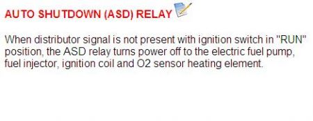

My info for the code 42 says the computer thinks there is a short or open circuit at the asd relay. Dark blue is ignition feed to coil side of relay, it comes from the computer. Dark blue with yellow tracer is ground for coil side of relay. Red wire is battery voltage for load side of relay, probably hot all the time. Dark green wire with black tracer, carries voltage to everything the asd relay controls. You may need to take wiring circuits loose on both ends and do continuity test?

https://www.2carpros.com/forum/automotive_pictures/170934_dodge_caravan_4_cylinder_1.jpg
Yes, with key on, there will be voltage to the load side of asd relay, and the coil side of relay. The computer controls the ground side of relay coil. If no ground, the relay won't energize, even if there is voltage.

Went home trying to figure the compatablity from 1988 to my 1989, I ran across the MAP sensor test. The author said the MAP sensor will act like a failing fuel pump. The car will try to start but will die like the fuel pump is bad. The test is simply to unplug it. The car will run ruff but not die after starting. I did this and went to pull a part and got two for 3 dollars. Problem solved. When I unplugged the dang thing I got a code 14. If I would have known the MAP sensor acts like this I could have saved a lota time. Thanks for your input anyway. John.
