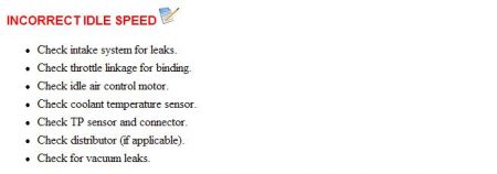

BLUELIGHTNIN6
  • 16,542 POSTS
Go ahead and check out these components listed below, they can all cause faulty idleing.
https://www.2carpros.com/forum/automotive_pictures/261618_Noname_976.jpg
Wednesday, September 16th, 2009 AT 9:58 PM
