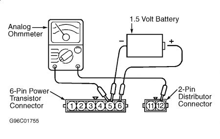

Fuel pressure good 47-50 psi. Code 43 requires some specialized test equipment but can check out some basics-Compression test-Check spark is it blue/white with a snap?-Test Ignition Power Transistor see diagram, with battery applied should read continuity pwoer removed no continuity.
https://www.2carpros.com/forum/automotive_pictures/198357_Graphic_212.jpg

Forgot illustration does this help?

Well I have checked the conectors and cleaned them. But Im just wondering why I need to check continuity. I mean obviously its working up to par since its sparking and works fine with light throttle tension. Well one more thing im not sure of once I had it checked with a scanner one of my buddies brother had. One thing I remember is he said he dont know why at idle my TPS shows as 24-25% throttle I dont know but that sounds too high for me I thaught at highest it should read like 8-10%. As far as the compression check my only thing is why would it run perfect throughout rpm ranges if I had bad commpression. See if I slowly press the throttle it will redline without the slightest misfire. Only when I jam on it does it do what its doing. I just wish there was a way to put a video on here exactly what its doing cause its hard to explain. Anyways thank you again. Till next time.
