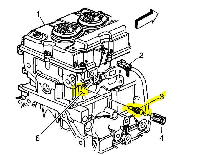

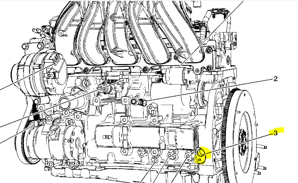

I thought it could be the fuel pump, but this problem has been so intermittent that it threw me off about it possibly being the fuel pump. Sometimes it will go for a couple of weeks before having a stumbling or shutting off issue.
If it is the crankshaft position sensor, where would it be located? I might just try replacing it before doing the fuel pump to see if it fixes the issue.

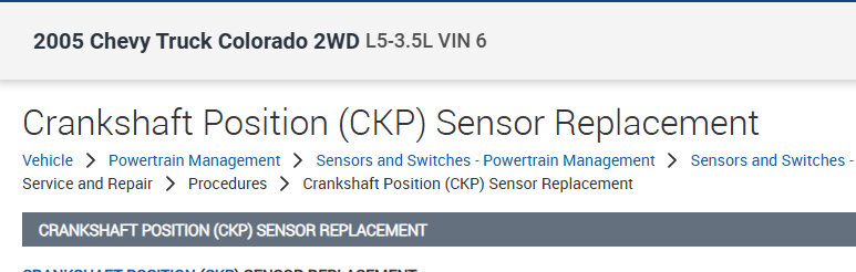

The crankshaft position sensor is usually affected by heat. However, anything is possible. I have attached the removal instructions below. It is at the rear of the vehicle, close to the transmission bell housing on the driver's side.
Let me know if this helps.

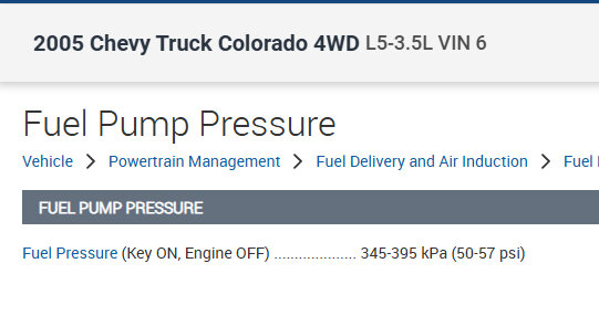

Have you ever checked the fuel pump pressure to ensure it is within specification? If you haven't, that may be a good idea. If it is good, I recommend trying the sensor to see if that resolves the issue.
Here is a link that shows how it's done:
I have attached the manufacturer's fuel pressure specifications below.
Let me know your thoughts.

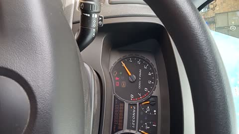

Well, we're very frustrated with this truck. Putting in a new throttle body did not last long, only a couple of weeks. We drove it to Amarillo, and it started acting up again. Now it's even worse and it's still not throwing codes. We did, however, replace the crank position sensor which is what was thought was wrong with it previously. But now it's doing something new.
When we drove it to Amarillo and back, approximately a 220-mile round trip, Marty engaged the cruise control and it was having intermittent issues, then it did throw a code and said it was the CPS, so we replaced it. The truck ran fine for a couple of weeks and then began acting up again.
Now it's doing something new. It won't start at all when it's cold outside. So, we did some more investigating and came up with an ambient temperature sensor. However, information on where it says it's located seems to be false. It says it's located between the front bumper and the bottom of the radiator. We can manage to get it started when it's warm outside, but if we attempt to drive it then it dies on us. But we're afraid to drive it in case it won't start again.
Here's another new thing it's doing. With the key in the run position, engine not running, but all the relays under the hood are clicking, snapping, and popping. He attempts to start the engine and it won't start. It is cold outside. Also, the check engine light on the dash blinks, but it's still not throwing any codes.
I think the ECU/ECM has gone out. It makes sense because the poor truck has gone crazy. Either it has lost its mind or poor old Pop is possessing it. I have provided a short video for you to see what it's doing.

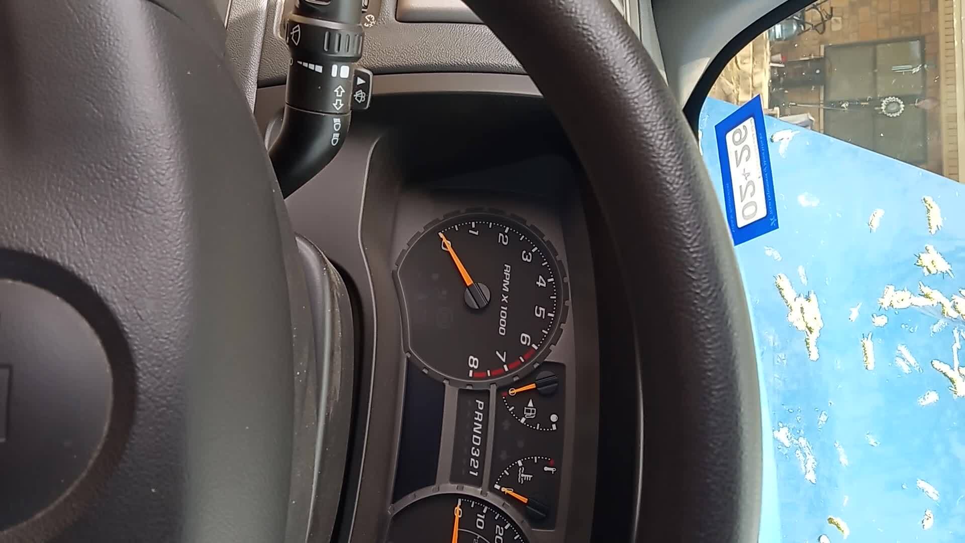

Hello. Before I begin, I'd like you to know that Marty is a retired certified mechanic. His disability caused him to have to retire before all this new-fangled electronic stuff came into play, though he has always read up on it, we just haven't experienced it "personally" until recently. Up until recently we haven't owned anything any newer than a 1989 Isuzu Pickup. Then about 5 years ago his brother gave him a 2004 Ford Expedition, and last year he inherited the 2005 Chevy Colorado from his father. So, computerized vehicles is foreign waters for us. However, compared to the Ford, the Chevy has been a complete mystery for us. The Ford is good at throwing codes when there's something wrong with it, but the Chevy not!
Anyway, he drove it to the store yesterday and it started and ran without missing a beat. However, when he got back in the truck to go home, it started acting up again. After he got back home, he hooked up his code reader and it threw code 2610 which says it's the PCM. But then he began doing some more investigating on the internet and some sources say that just because it throws a 2610 code, it may not be the PCM.
If the diagnostic tool throws a specific code that relates to a specific part, then how can it not be the part the code is related to? That just does not make any sense! I thought that's what the code reader was for, to tell you when it's throwing a code that the part is bad which is related to that code. If that is not the case, then how is a mechanic at a shop to know which part to replace? Wouldn't that just make it that the mechanic is throwing parts at it until it doesn't throw a code anymore? We can do that here at home.
It is my belief that the code reader is supposed to tell you which part is bad, so you replace the part which is related to the code in order to prevent you from throwing parts at it until it stops acting up. I do understand that the code reader does not relate to certain parts such as the fuel pump. But isn't it supposed to tell you what is connected to the PCM? Then, what if the PCM is bad, could it cause all this mysterious stuff to be happening?

This code can be the PCM if you have not disconnected the battery recently.
P2610 - ECM/PCM Internal Engine Off Timer Performance.
The engine timer is an internal feature inside the PCM so it will need to be replaced. You can get a preprogrammed unit by searching Google or Ebay.
