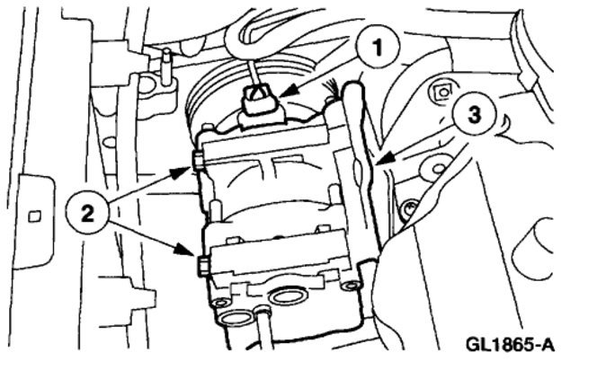

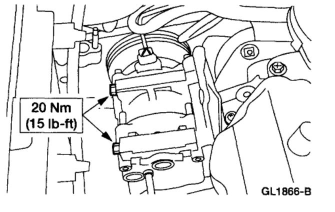

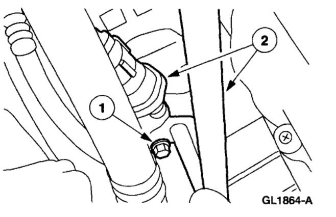

Yep, its sounds like the compressor is the problem like its locked up or the clutch coil is shorted. Here is a guide to help you get the problem fixed. Try unplugging the compressor to confirm.
https://www.2carpros.com/articles/replace-air-conditioner-compressor
and
Compressors are cheap on Amazon - $149.00
https://www.amazon.com/gp/product/B00JXZIRAI/ref=as_li_qf_sp_asin_il_tl?ie=UTF8&tag=2carprcom-20&camp=1789&creative=9325&linkCode=as2&creativeASIN=B00JXZIRAI&linkId=ceb60c46083b93a8807e481dca3b93b9
